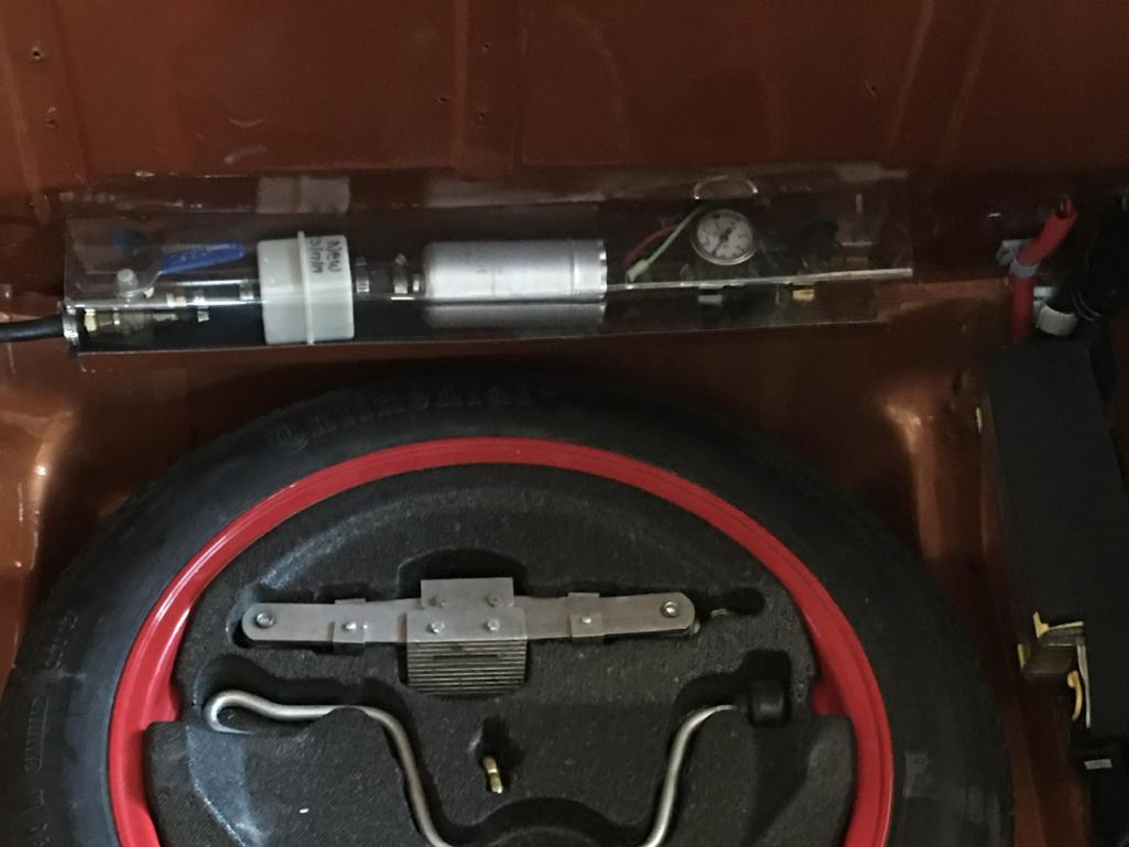

jim_hoyland
post Sep 21 2021, 06:53 PM
Get that VIN ?
Posts: 10,077
Joined: 1-May 03
From: Sunset Beach, CA
Member No.: 643
Move the filter and pump to front trunk; added a shut valve and pressure gauge . A lexsn shield was added to protect the set-up

jim_hoyland   Move the filter and pump to front trunk; added a s...   Sep 21 2021, 06:53 PM
nditiz1   Jim that looks great I may replicate when I move i...   Sep 21 2021, 07:11 PM
