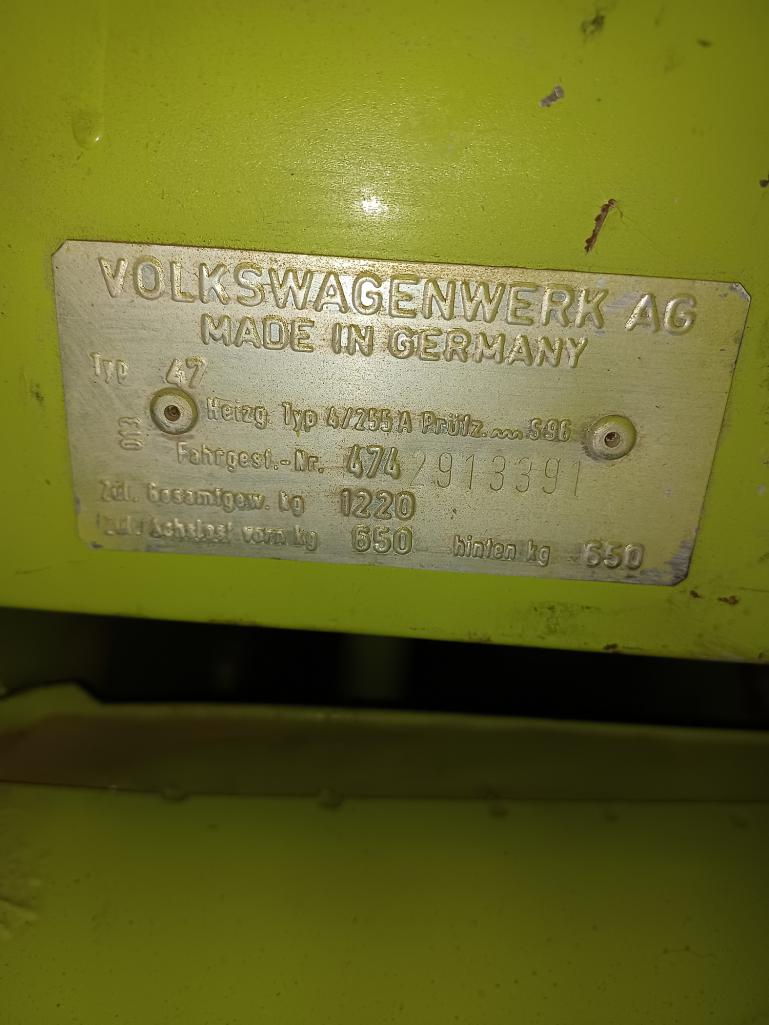

Puebloswatcop
post Oct 8 2021, 09:45 AM
Posts: 1,782
Joined: 27-December 14
From: Mineola, Texas
Member No.: 18,258
The original Body Tag is still attached to the right headlight bucket

Puebloswatcop   The original Body Tag is still attached to the rig...   Oct 8 2021, 09:45 AM
