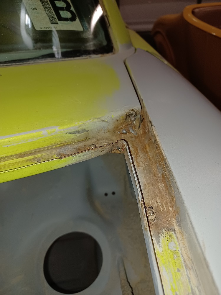

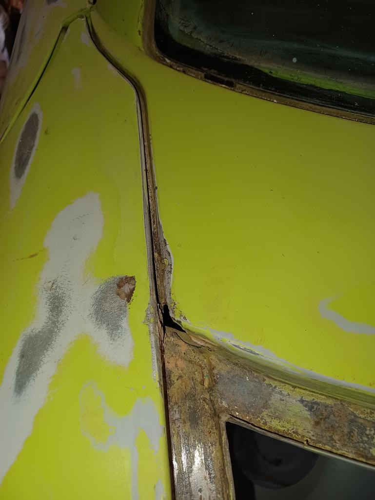

And of course the channel corners where the cowel meets the fenders are rusted out
