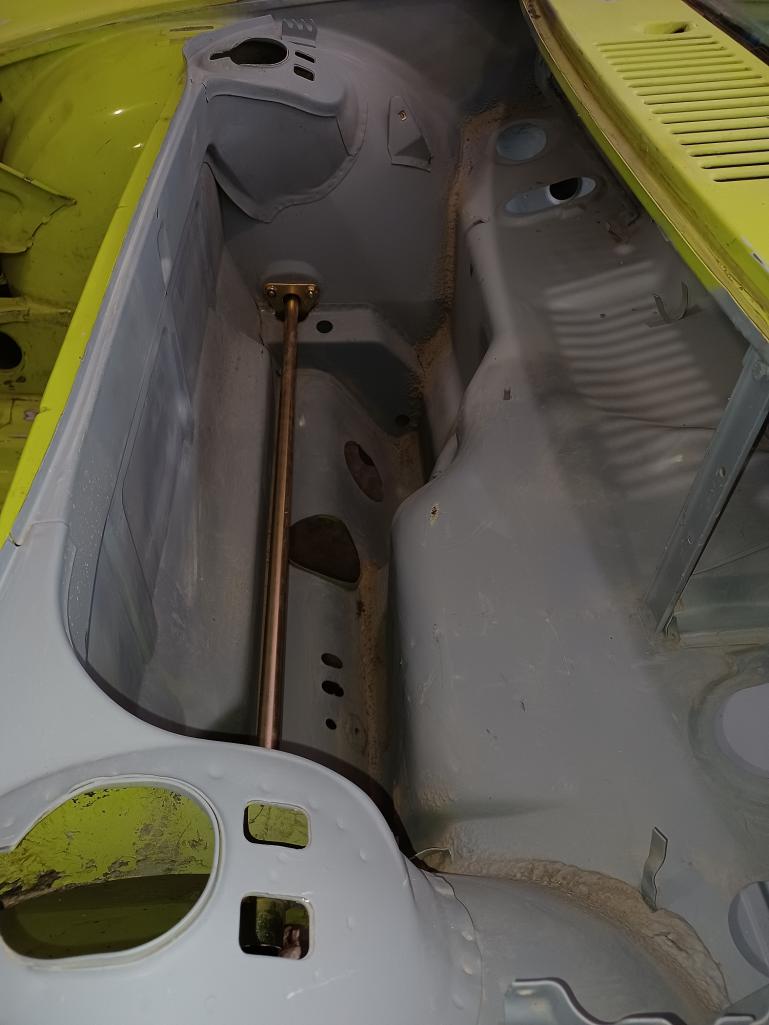

Puebloswatcop   The firewall and gas tank area are in great shape ...   Oct 8 2021, 09:53 AM
