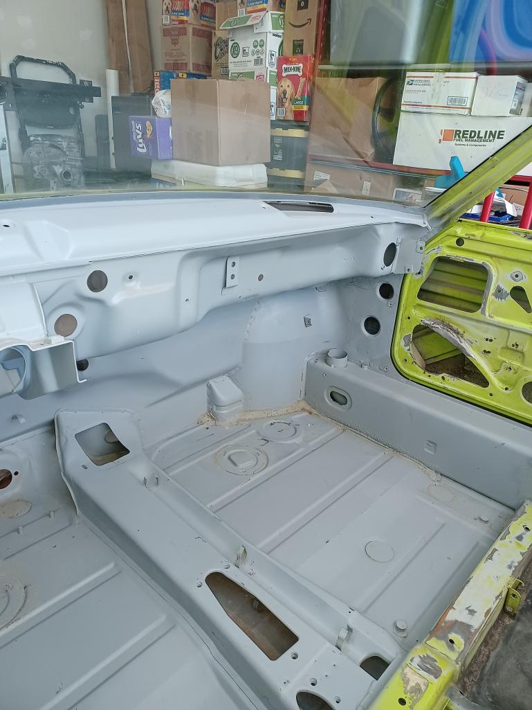

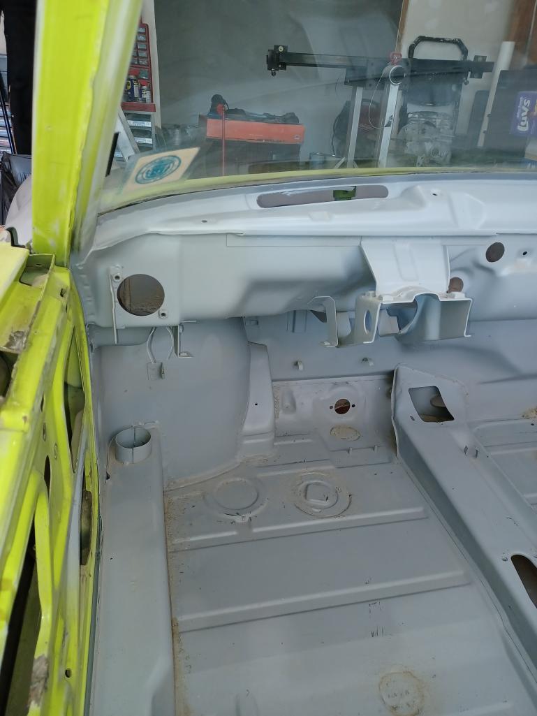

Puebloswatcop
post Oct 8 2021, 10:03 AM
Posts: 1,782
Joined: 27-December 14
From: Mineola, Texas
Member No.: 18,258
The interior front half of the floor is in remarkably good condition as well
