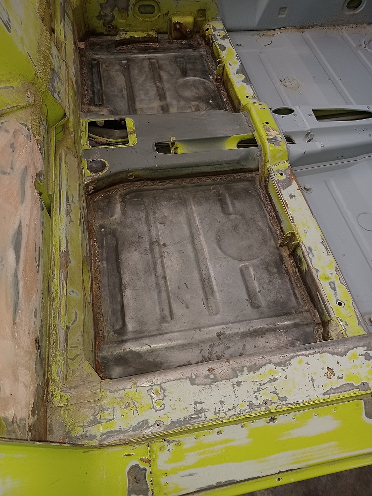

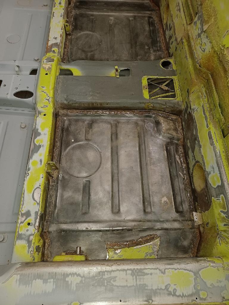

Puebloswatcop   The rear floor half has been replaced, but still h...   Oct 8 2021, 10:09 AM
