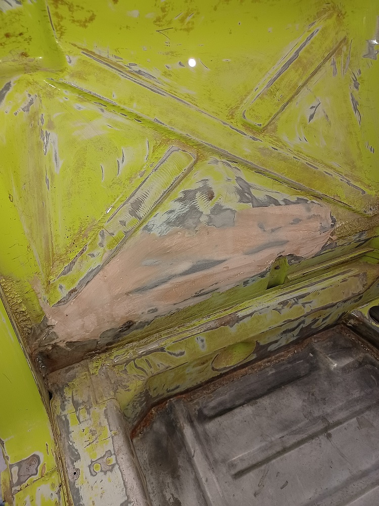

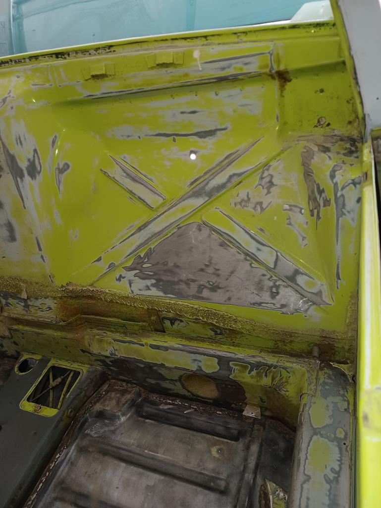

Puebloswatcop   The rear wall on the drivers side is solid, the pa...   Oct 8 2021, 11:40 AM
