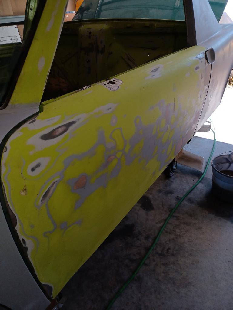

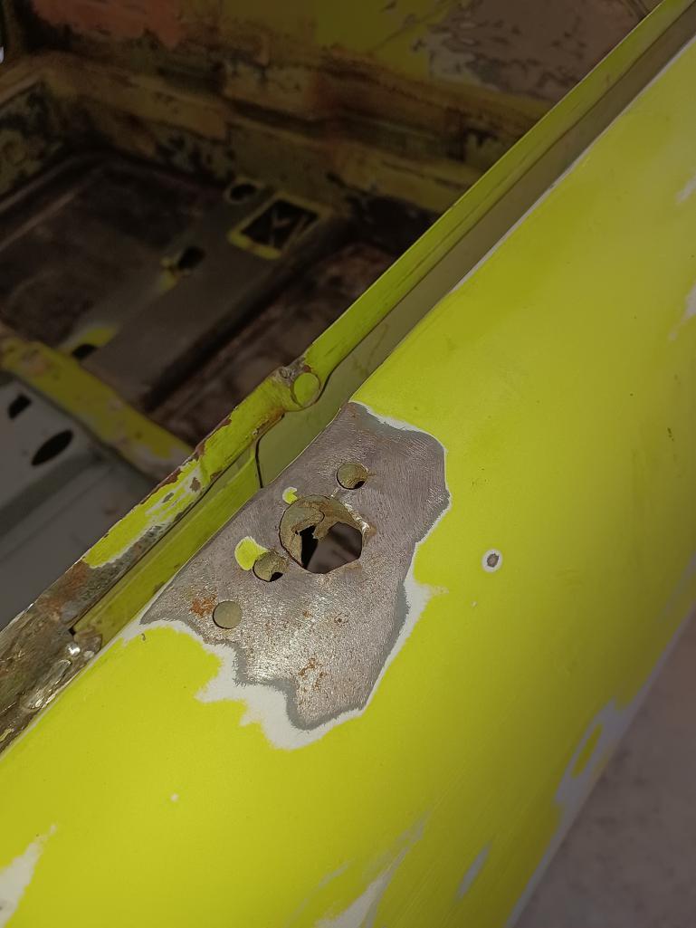

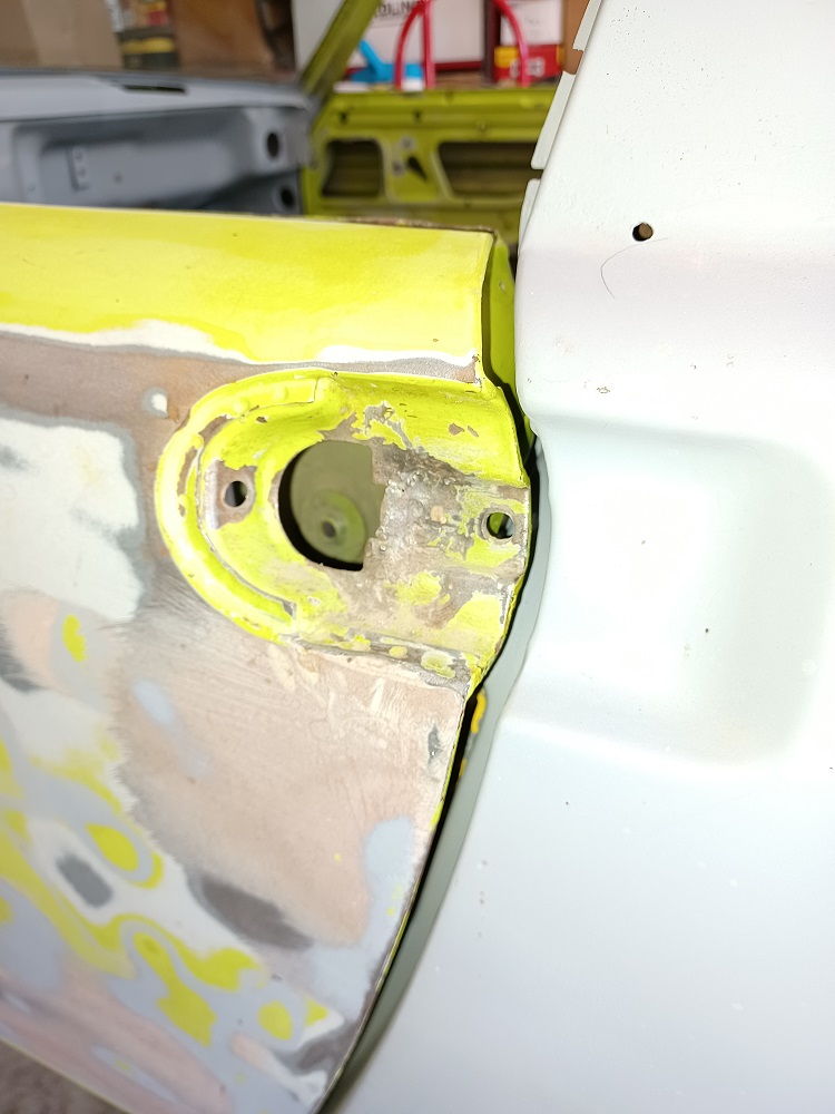

The drivers door leaves a bit to be desired. The door itself is pretty solid, no rust, however the IPO tried to attach adjustable mirror to it and blasted out the mirror support underneath the skin and cut more holes. The door handle pocket is a bit rough as well. And of course the obligatory speaker hole cut to the inside of the door. But hey on a positive note the paint tag is still in the door frame....

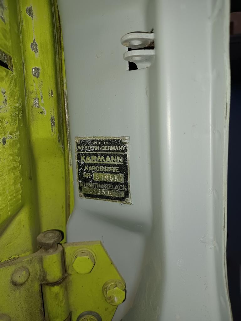

Puebloswatcop   The original Body Tag is still attached to the rig...   Oct 8 2021, 09:45 AM

Puebloswatcop   The drivers door leaves a bit to be desired. The ...   Oct 8 2021, 11:51 AM
