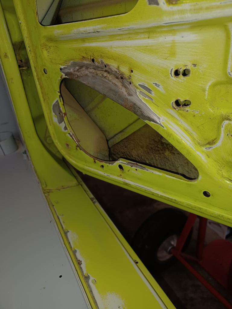

Passenger door is good except for the speaker hole and couple extra drille holes on the inside. Good and solid though, with no rust. You can see I already started repairing the speaker hole.
