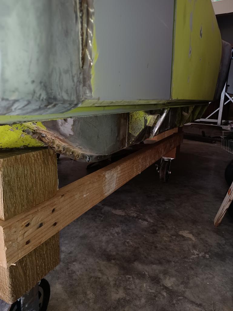

Puebloswatcop   The rear floor half has been replaced, but still h...   Oct 8 2021, 10:09 AM

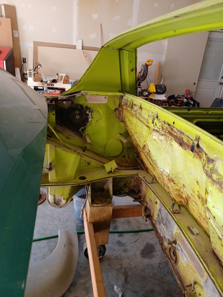

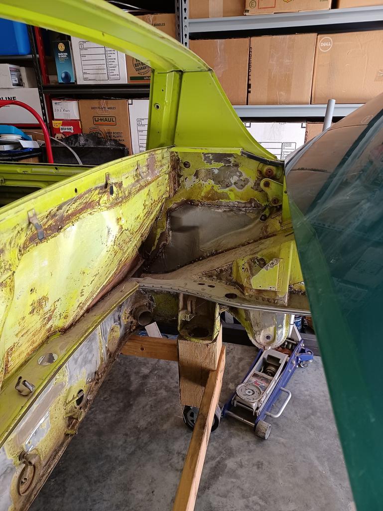

Puebloswatcop   Further inspection up under the drivers side fende...   Oct 8 2021, 12:18 PM
Puebloswatcop   Inside the right rear fender well, you can see the...   Oct 8 2021, 12:23 PM
