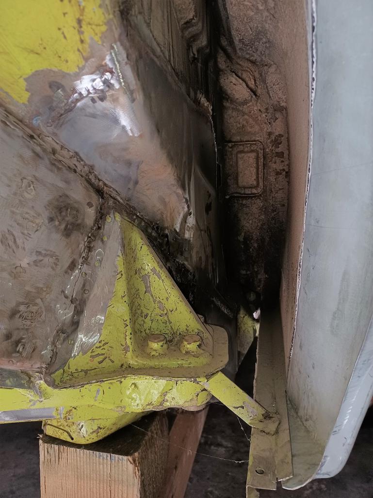

Inside the right rear fender well, you can see the repair panel installed for the engine compartment, also a ton of cleaning to do, but things look pretty solid at this point
