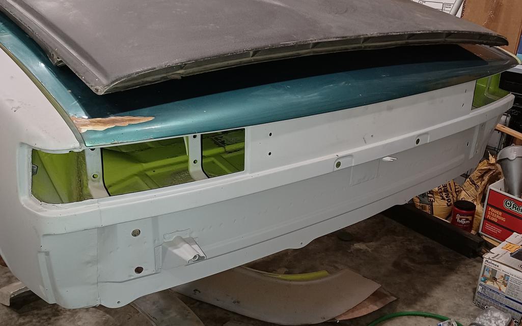

The rear trunk is good and solid, however the mounting points for the jack are missing and the new plug is where the PO tried to put an oil cooler in, so several extra holes to be welded up. The rear wall is in excellent shape, but as you can see in the picture, the trunk lid has damage to the rear left edge,

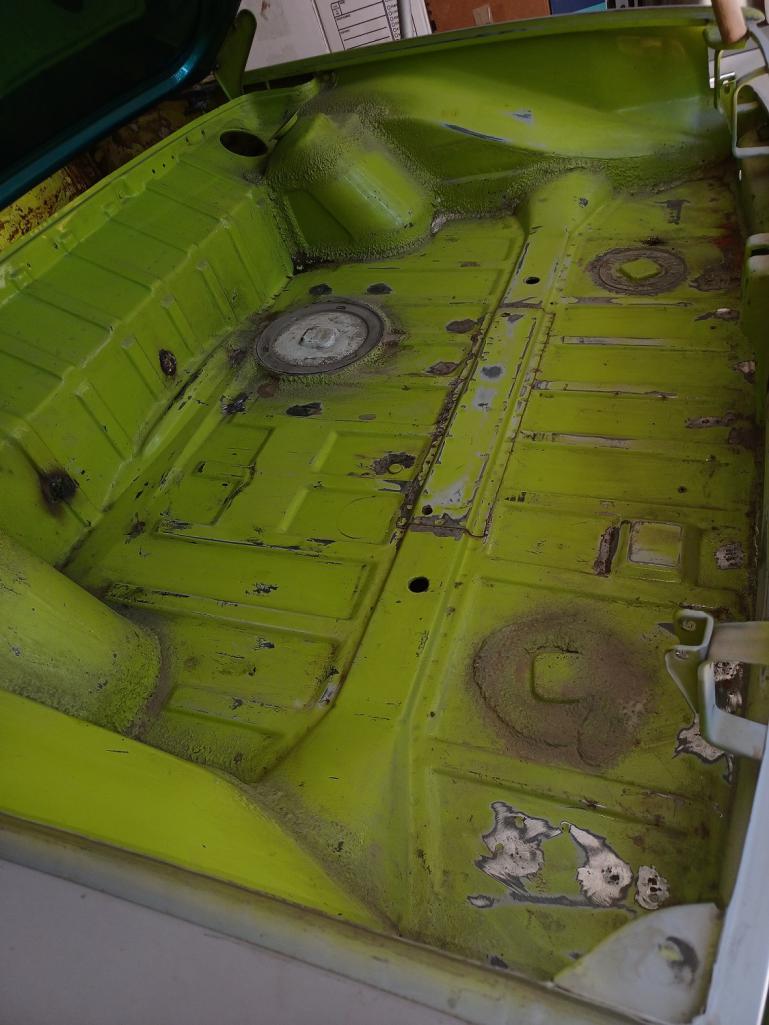

Puebloswatcop   The interior front half of the floor is in remarka...   Oct 8 2021, 10:03 AM
Puebloswatcop   The rear floor half has been replaced, but still h...   Oct 8 2021, 10:09 AM

Puebloswatcop   The rear trunk is good and solid, however the moun...   Oct 8 2021, 12:35 PM
