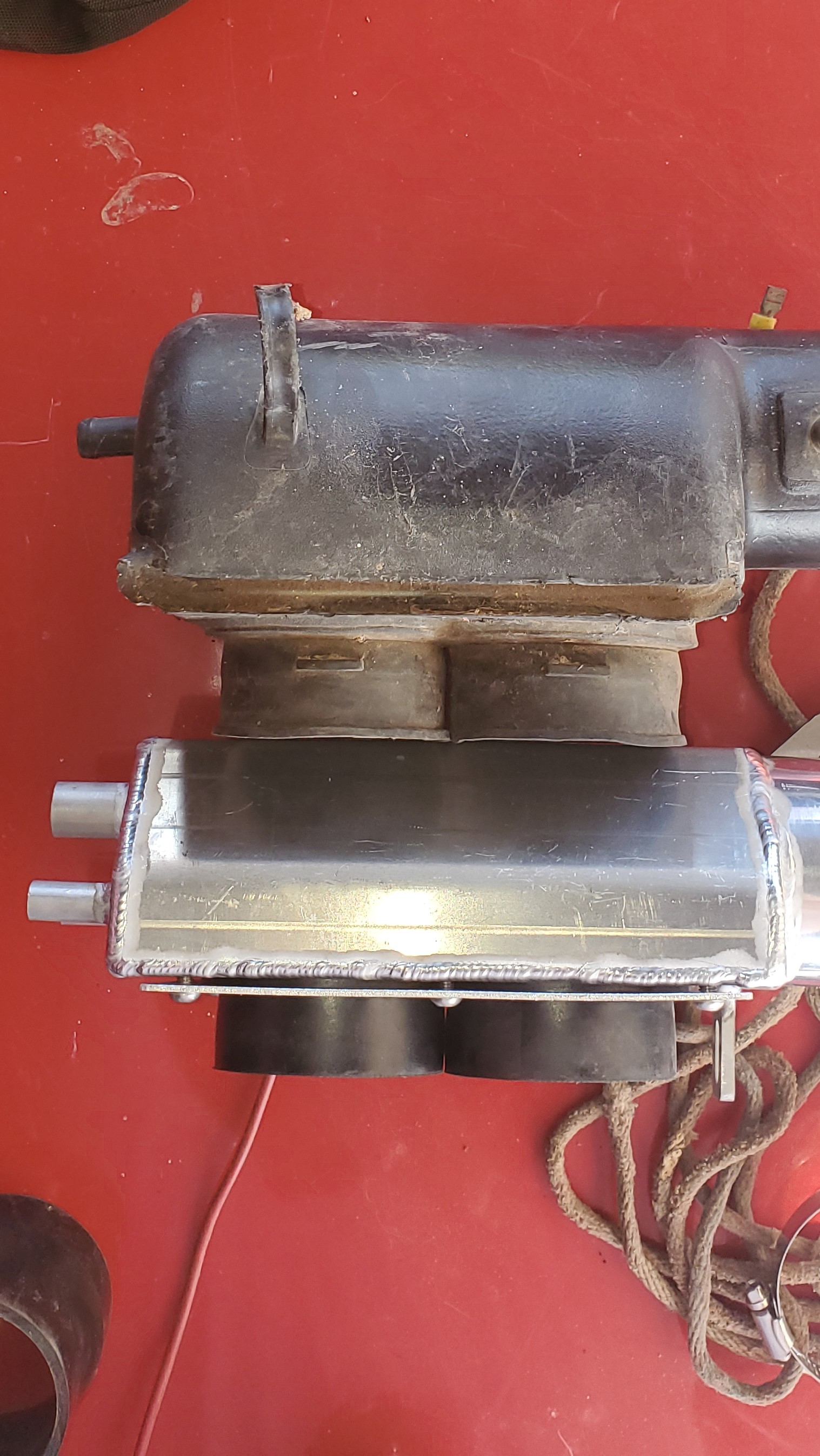

flmont
post Oct 9 2021, 05:57 PM
Posts: 881
Joined: 21-October 08
From: Tucson,Az
Member No.: 9,676
this is the new intake, smaller than stk but not by much,..will it perform the same ?? Thanks Attached Image

flmont   Iam trying to load a pic of my new intake that I h...   Oct 9 2021, 11:30 AM
SirAndy   Iam trying to load a pic of my new intake that I ...   Oct 9 2021, 11:43 AM
flmont   ok.Thank You,.! Frank   Oct 9 2021, 02:07 PM
flmont   RE: I guess Iam cutting it...   Oct 9 2021, 05:39 PM
flmont   this is the new intake, smaller than stk but not b...   Oct 9 2021, 05:57 PM
flmont   This solves a lot of issues if it works as in...   Oct 9 2021, 09:17 PM
Chris H.   That’ll work great Frank. Is that from Rocky Mou...   Oct 10 2021, 04:04 PM
flmont   Yes,.. it is from Rocky Mtn westy,.I check that si...   Oct 10 2021, 05:20 PM
