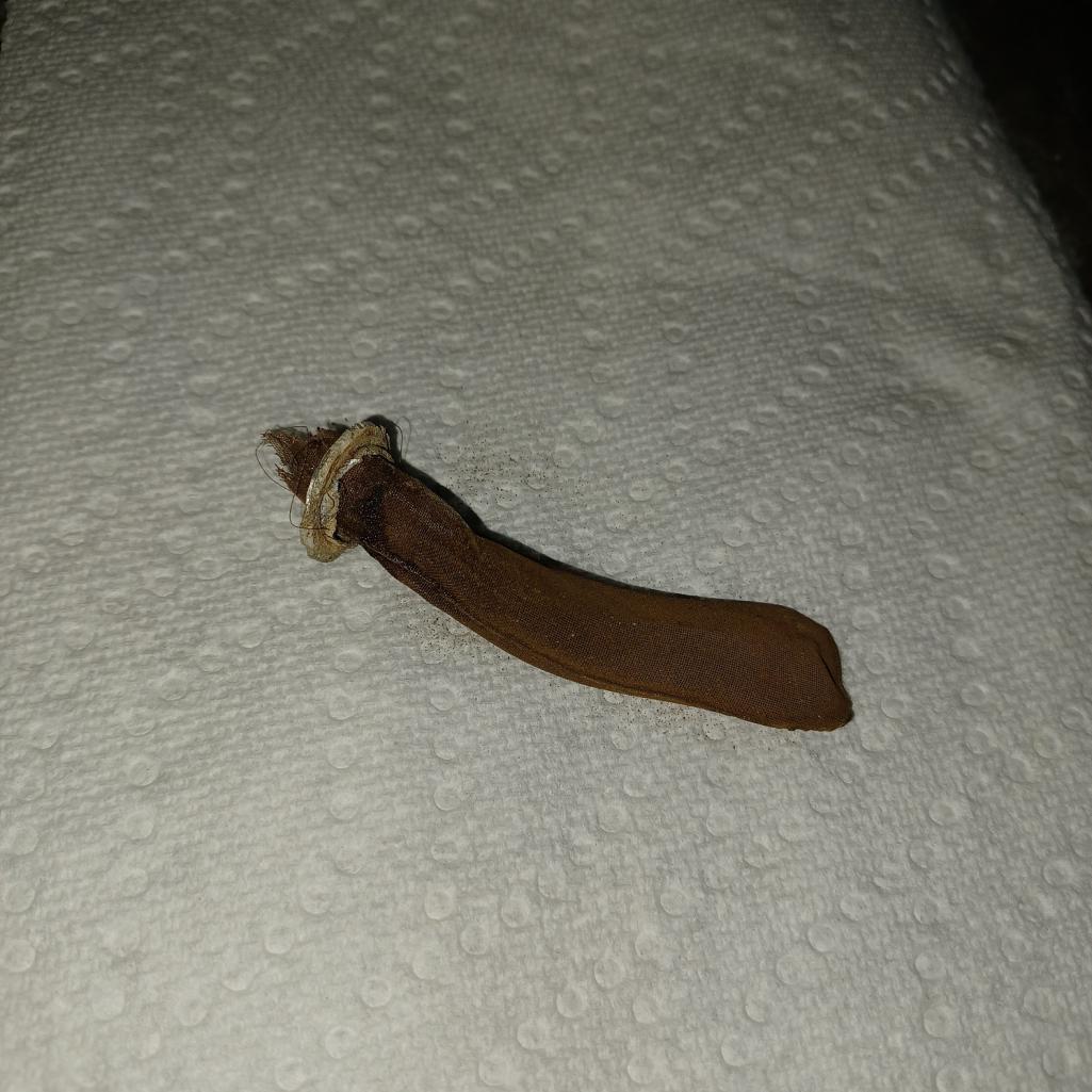

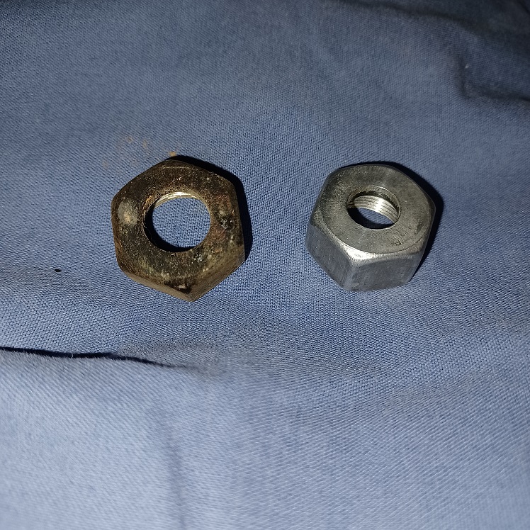

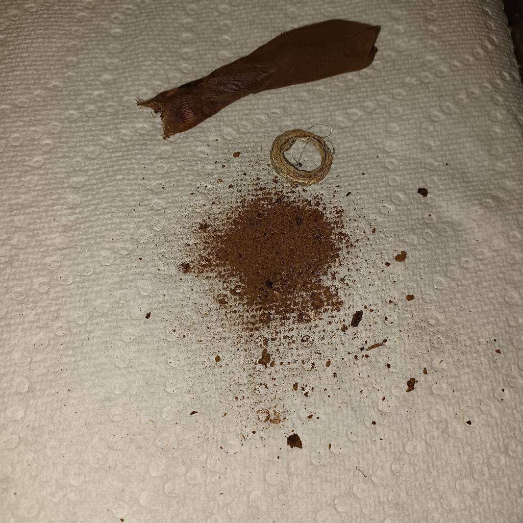

Puebloswatcop   After getting the tank dismantled I found that the...   Oct 10 2021, 11:13 AM
Puebloswatcop   The inside of the tank is not pristine, but looks ...   Oct 10 2021, 11:18 AM
