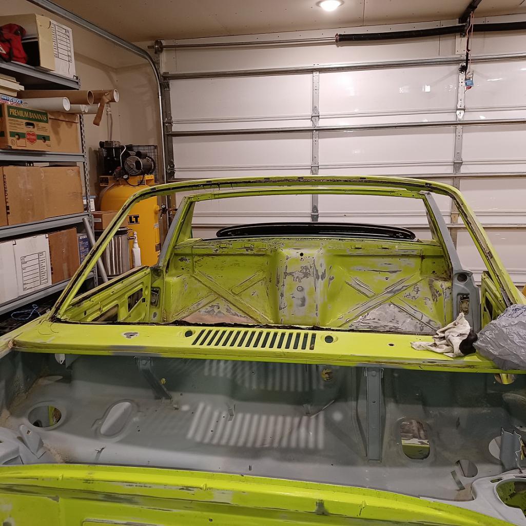

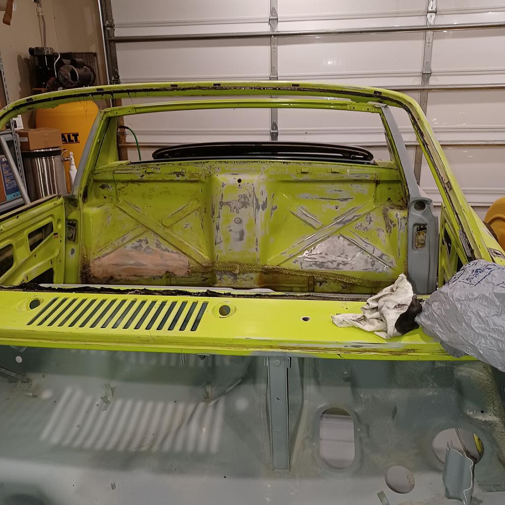

Any Advice on the best way to remove the windshield? I need to get it out so it doesnt suffer any damage. (IMG:style_emoticons/default/sawzall-smiley.gif)
So I tried using a thin copper wire and got about six inches around the windshield before that broke, tried a few strands wound together, al little further then the goop just clogged it up and no further. I wracked my brain and came up with some very thin welding wire......and 30 minutes later I had success.
Then it took another hour to get all of the mastic off of the window and another hour to scrape the majority of it off of the window frame. Man that stuff is nasty.
