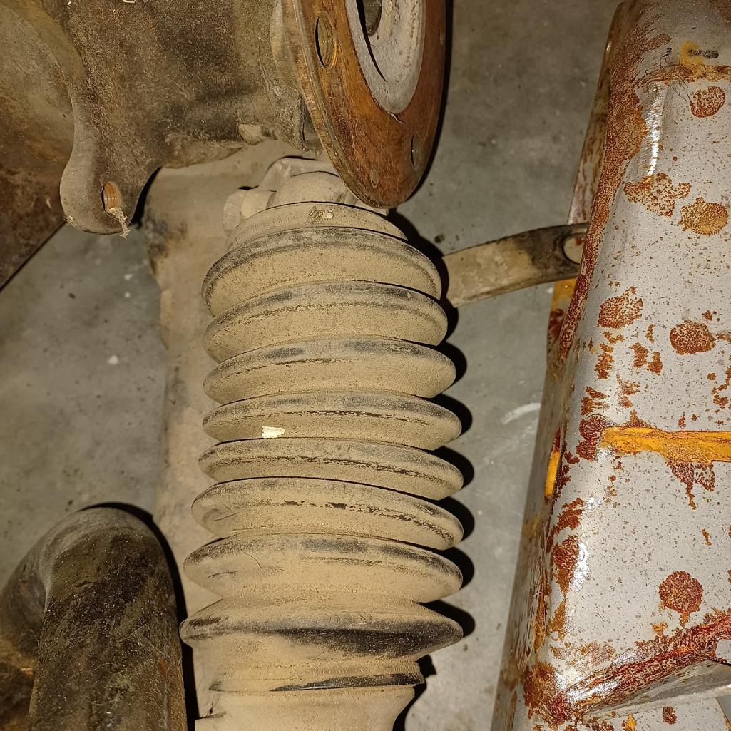

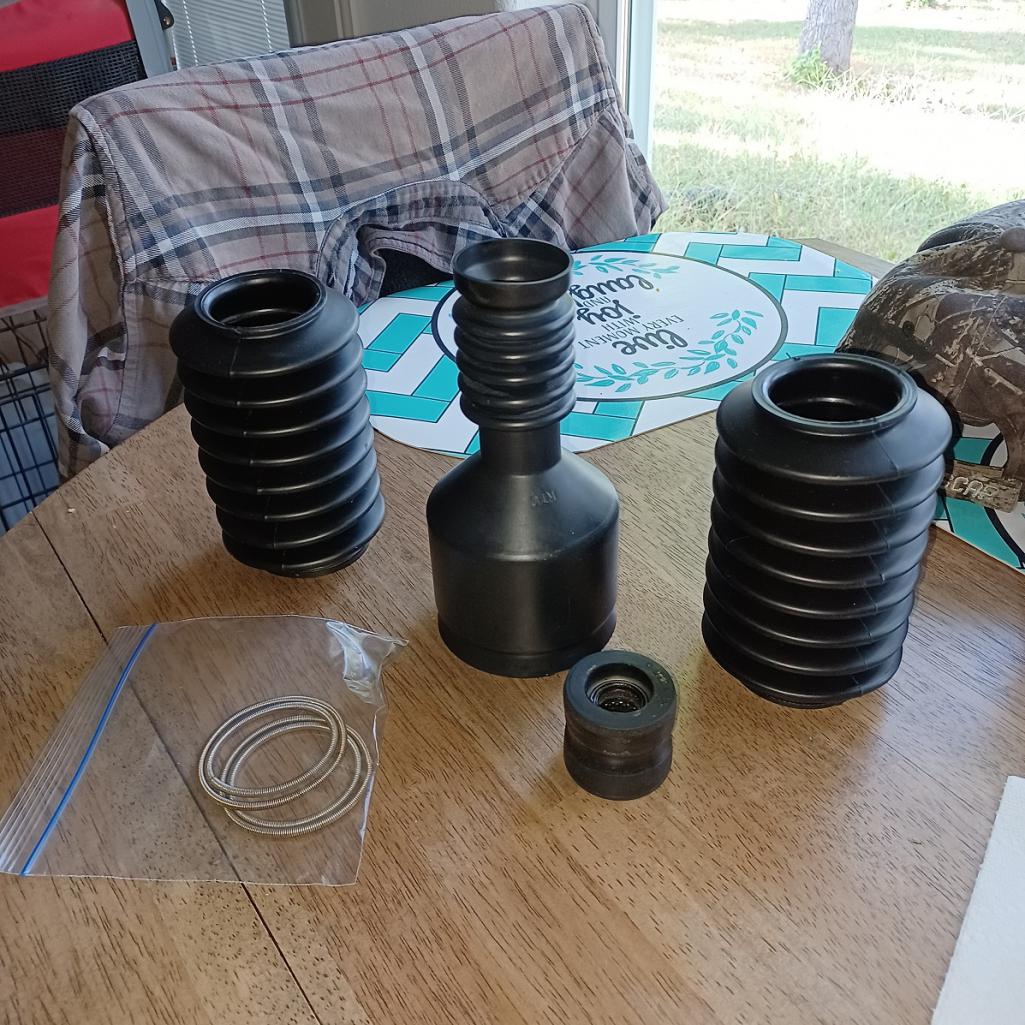

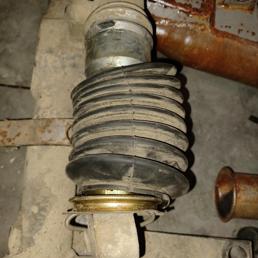

Dismantled the steering rack and cleaned up the rubber parts...
