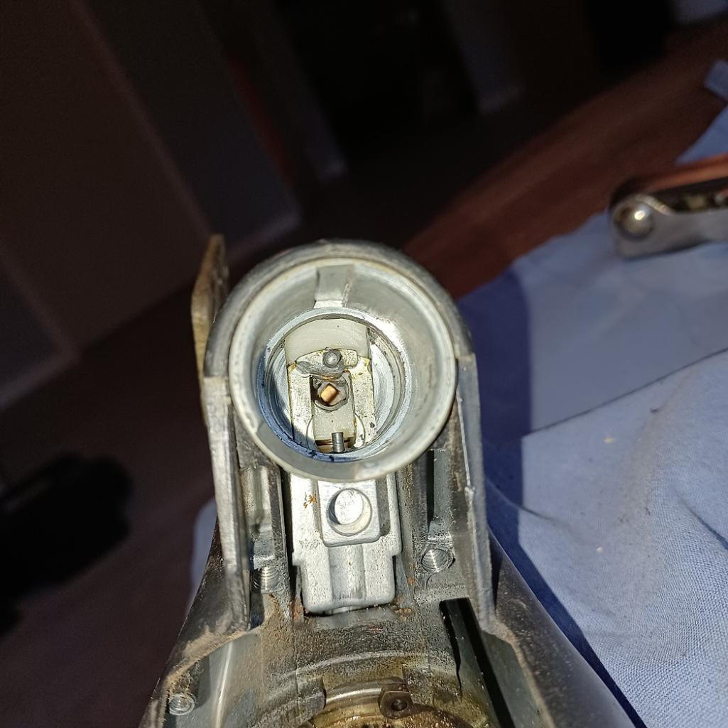

Puebloswatcop   Then I decided to start working on the steering co...   Oct 14 2021, 02:57 PM
Puebloswatcop   The deeper I got, I found the crud just continued....   Oct 14 2021, 03:03 PM
Puebloswatcop   So, as I suspected the upper bearing is shot, feel...   Oct 15 2021, 03:34 PM

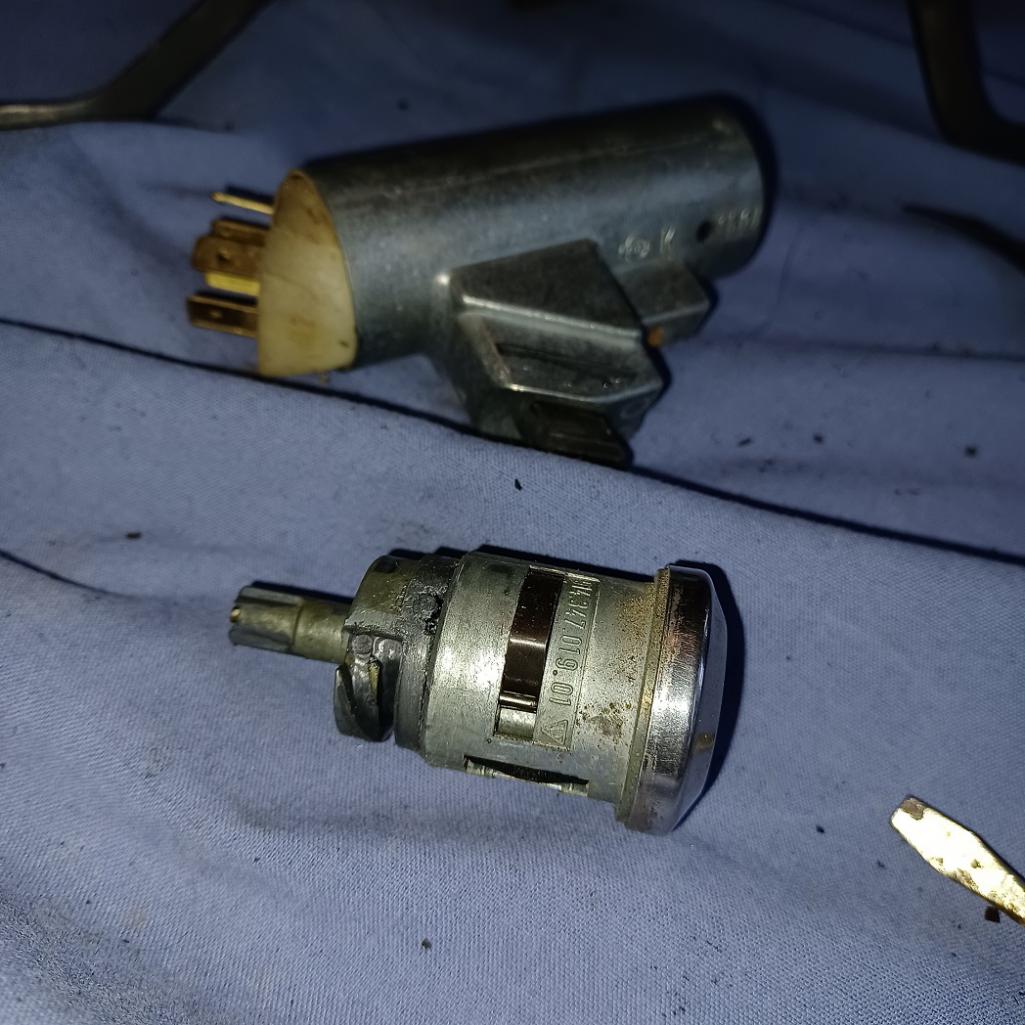

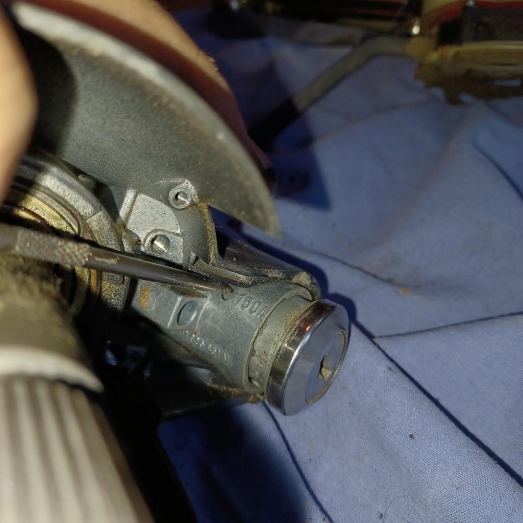

Puebloswatcop   From there i moved on to the ignition switch repla...   Oct 22 2021, 04:49 PM

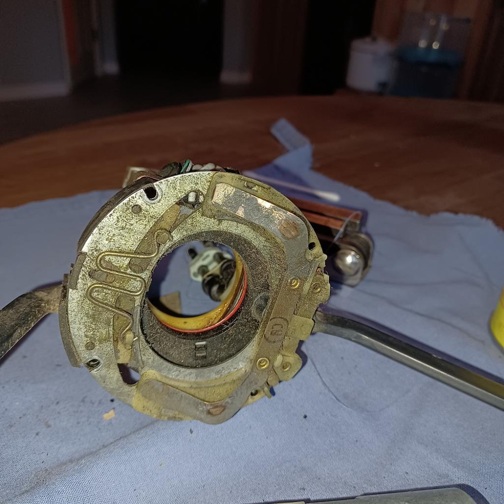

Puebloswatcop   Since I plan on changing from a stock steering whe...   Oct 22 2021, 05:03 PM
autopro   I wasn't aware of that wiper switch modificati...   Oct 22 2021, 05:23 PM
Puebloswatcop   I wasn't aware of that wiper switch modificat...   Oct 22 2021, 06:21 PM
