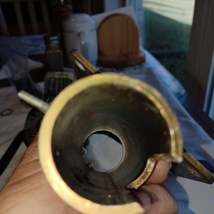

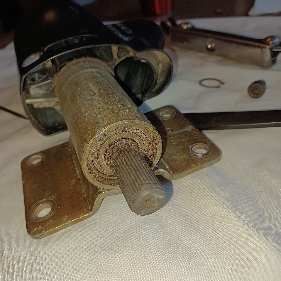

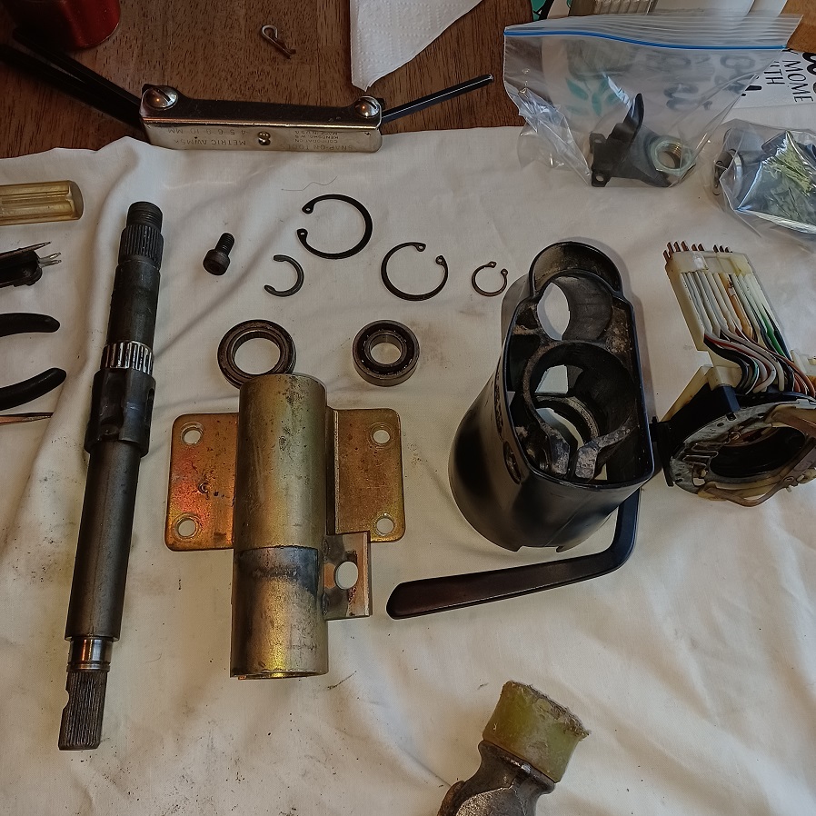

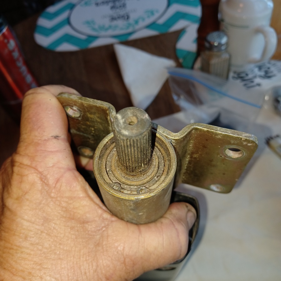

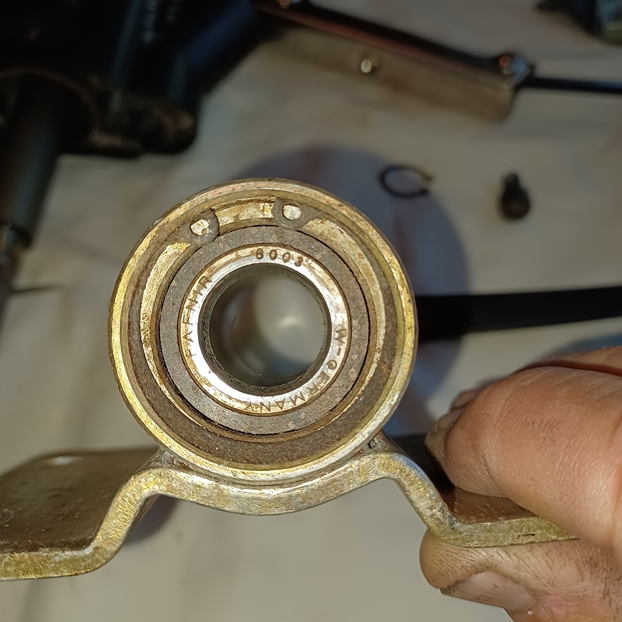

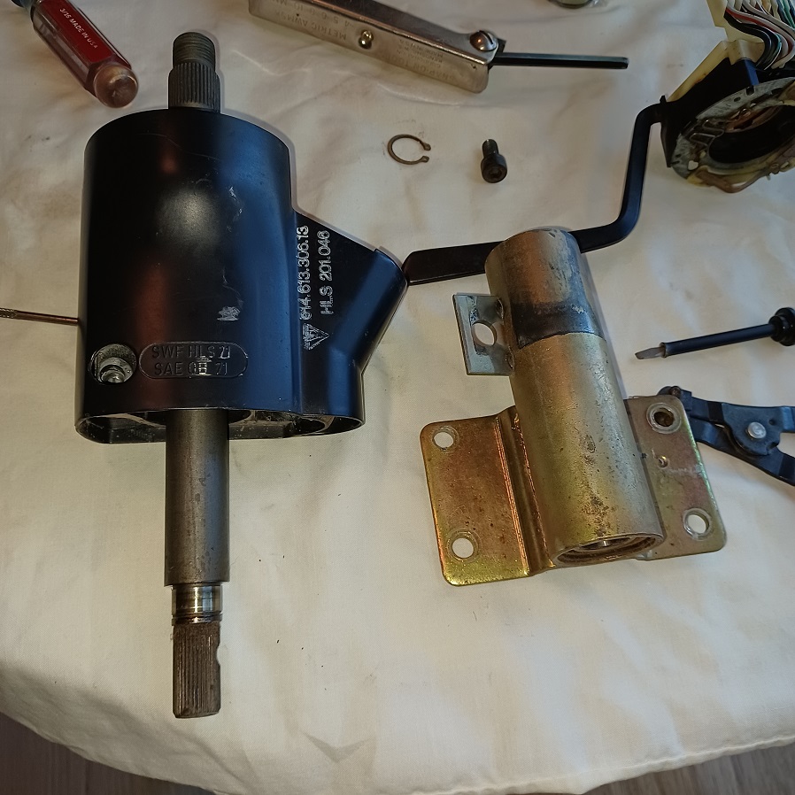

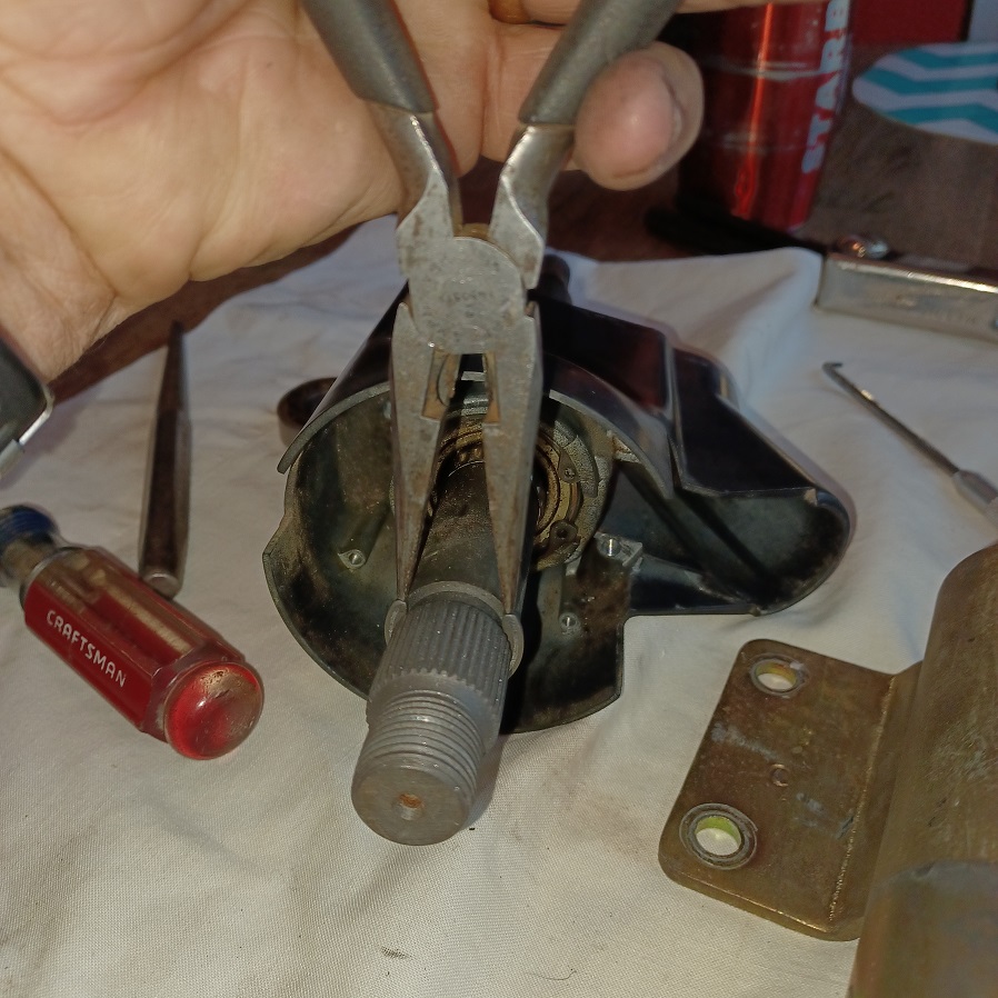

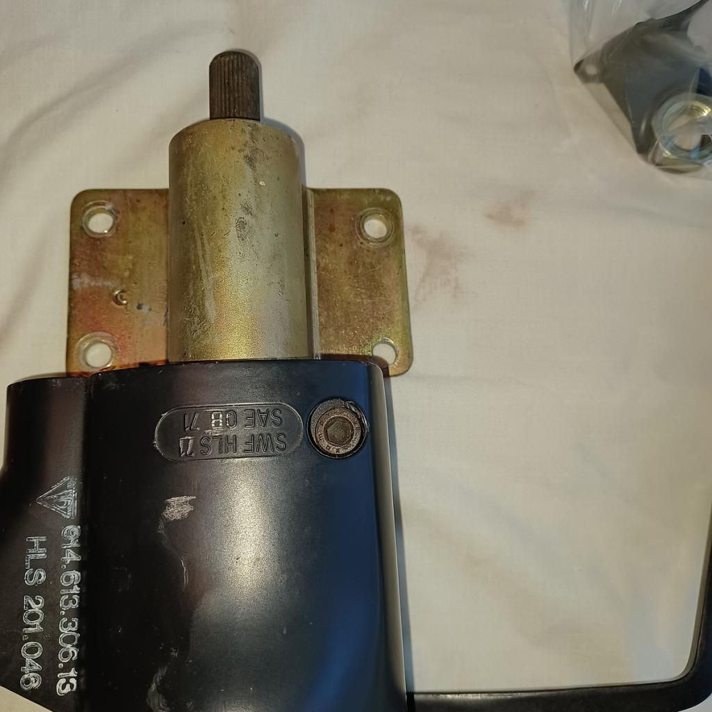

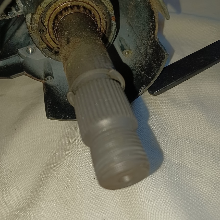

So, as I suspected the upper bearing is shot, feels like someone filled it with sand, the lower isn't too bad, but since I have it torn this far apart, I will just replace them both.
For those who have never torn the entire steering column apart, it really isnt a bad job to take on.
After all of the electrical components and ignition have bee removed the process is fairly simple

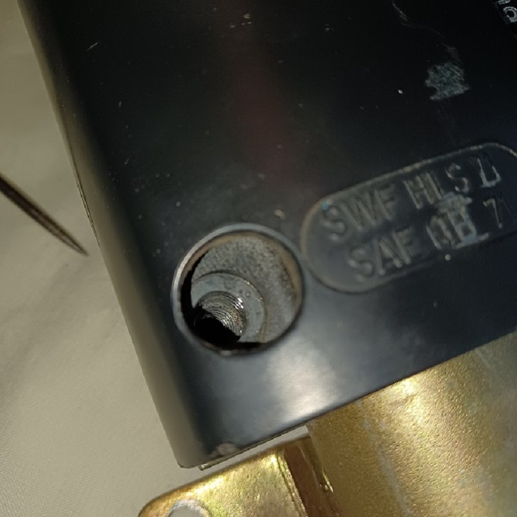

First remove the 6mm bolt from th under side of the housing
Then you can use a soft mallet to separate the Lower support from the black housing by tapping on the end of the shaft at the lower support end. I recommend doing this over a padded surface or have someone to hold the housing, becuase when the shaft falls through the housing end will drop like a rock...
This leaves you with the support with the bearing in it. You simply remove the circlip, then with a long punch or screwdriver gently tap the bearing out from the inside. Warning, if you plan to re-use the bearing, make sure you are tapping on the outer ring of the bearing. At the same time you will have to avoid the circlip that secures the underside of the bearing.
This should leave you with two individual components, The upper housing with the shaft in it and the lower support bracket.
To remove the shaft from the upper housing you will need to remove two circlips holding the shaft in place. the first is the ring on the shaft where the steering wheel mounts. I am sure they make a tool for this, but I don't have it so I just use needle nose pliers as positioned in the photo, give it one sharp blow and it comes right off.
Then you have to remove the circlip that holds the bearing in place. Then using the soft mallet, gently hammer the shaft out from the opposite end. Then simply pull the bearing off of the shaft. If this is done without a lot of force, you can generally re-use the crush washer that is between the bearing and the shaft.
That should leave you with a completely stripped steering column, to clean 45+ years of dirt and grime from.
The part numbers for the bearings are 91134777102 for the upper and 90005203100 for the lower. If you do need the crush sleeve that part number is 111 953 535 D
Hope this helps anyone considering this job
