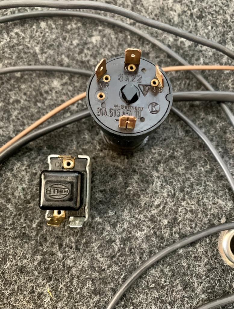

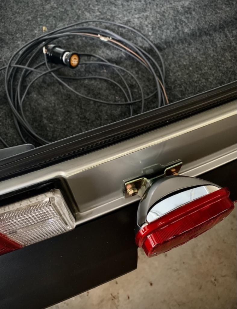

This is great info. I’m is the middle of installing the wiring and switch to operate my NOS rear fog light to my 914. I was under the impression the three position switch 914.613.451.10 was the correct switch to operate the front and rear fog lights.
