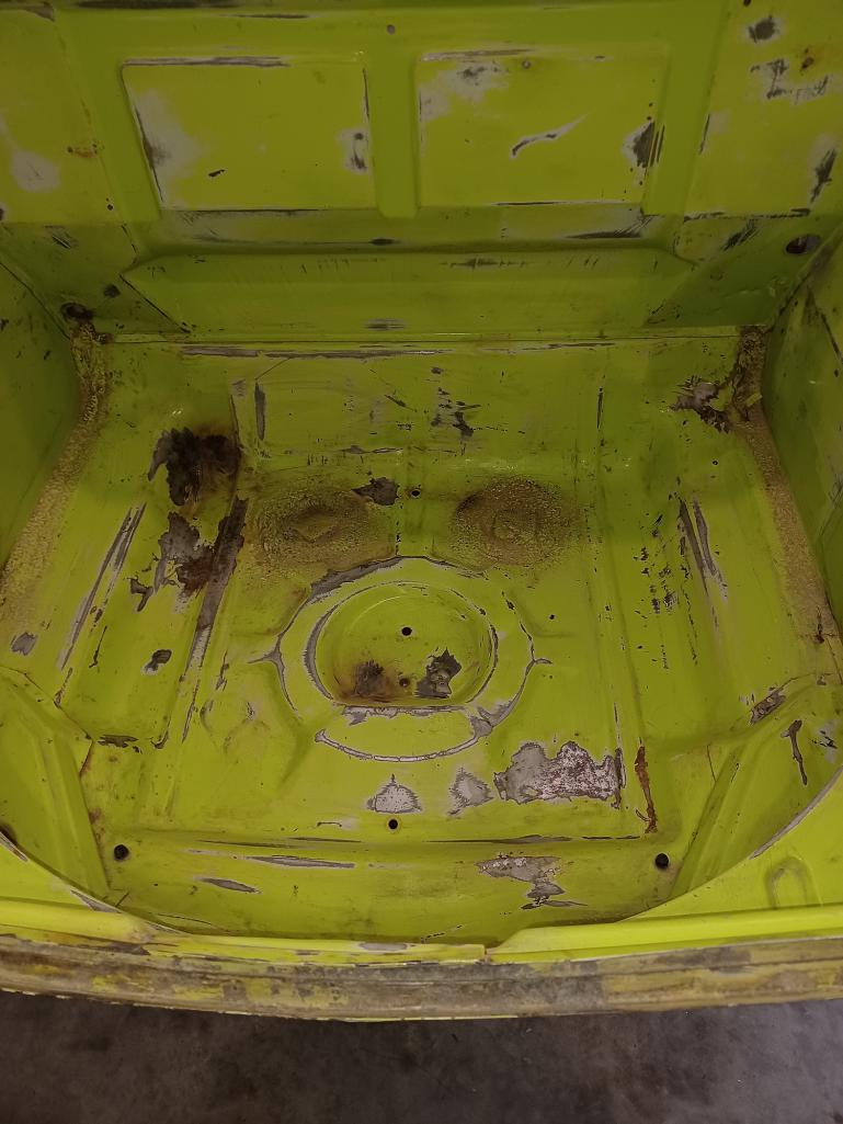

Puebloswatcop   The rear trunk is good and solid, however the moun...   Oct 8 2021, 12:35 PM
