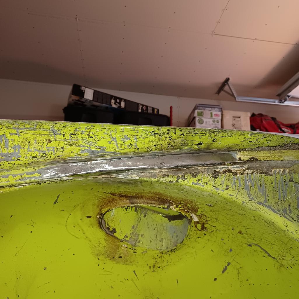

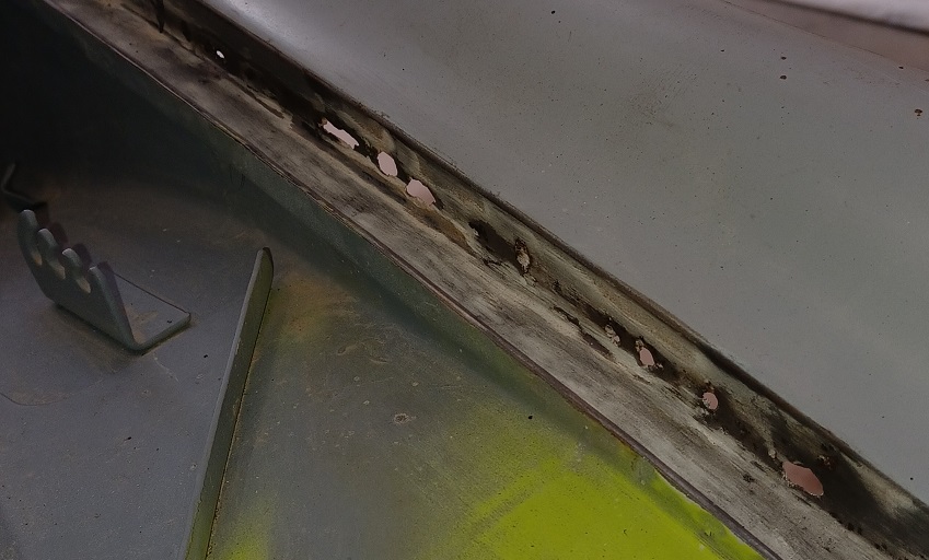

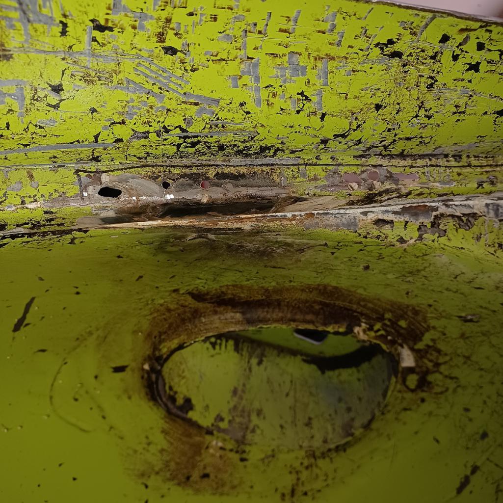

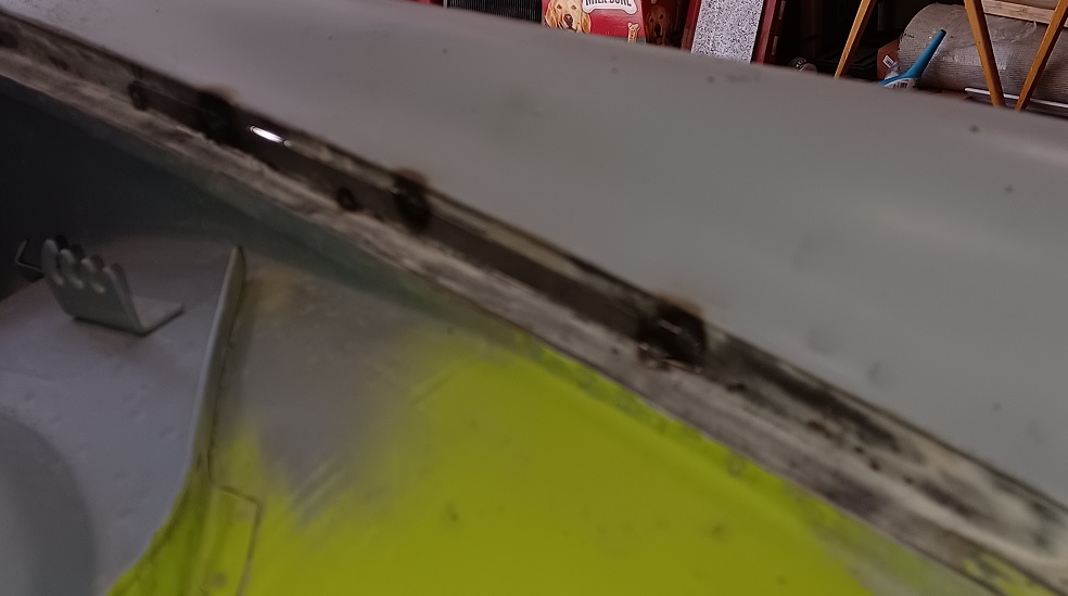

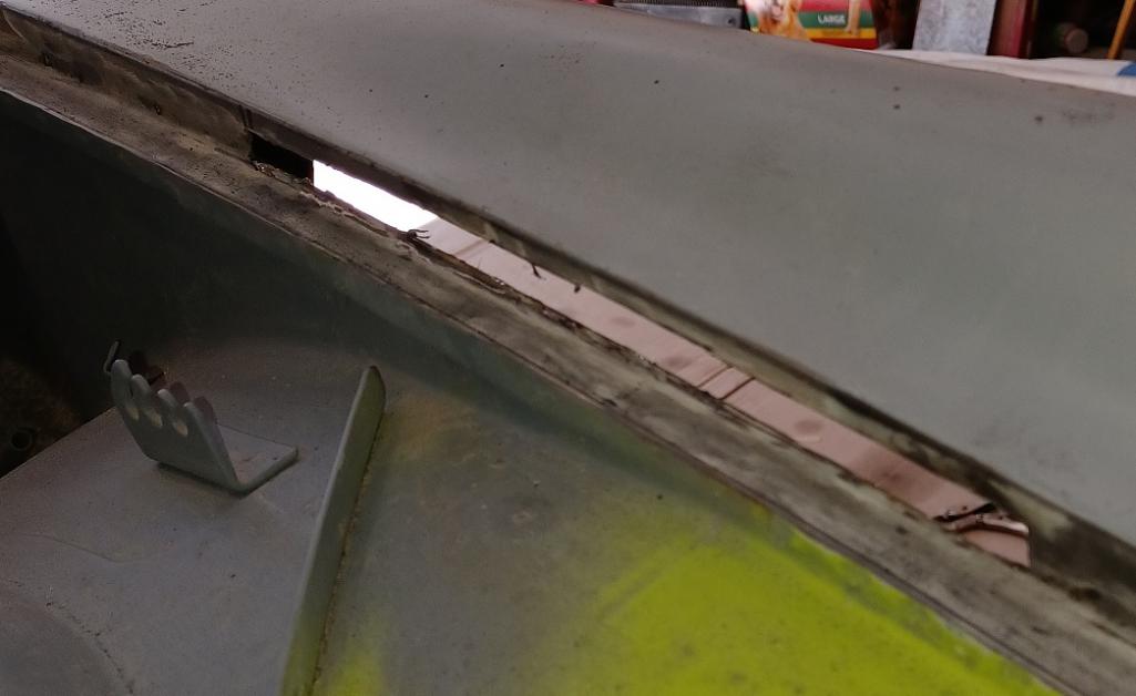

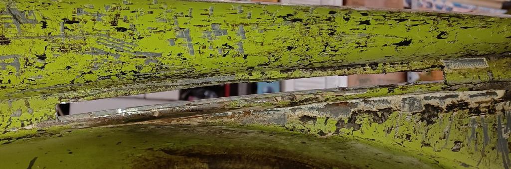

Then moved on to the rust along the drivers side fender in the front seal channel for the trunk lid seal. I started by cutting the rusted area until I hit solid metal, about 1/2 inch wide by about ten inches long.
Attached ImageAttached Image

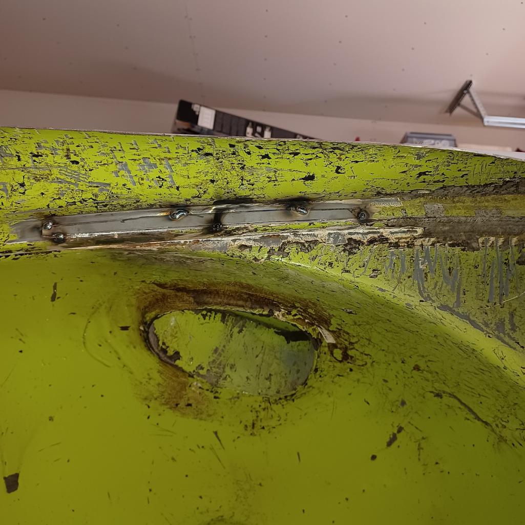

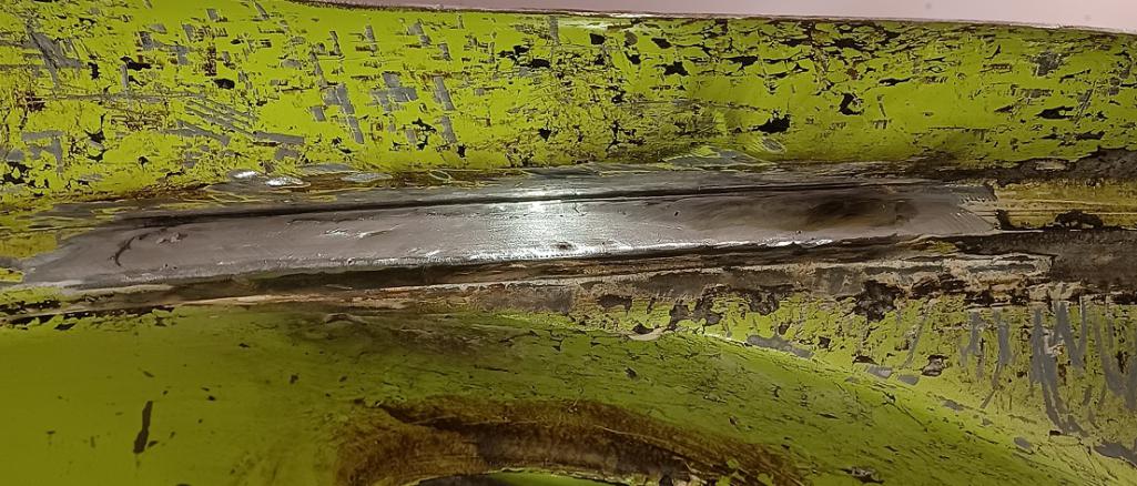

Then I cut a piece of metal to fit and tacked it in place. My goal was to not hit either the bottom edge or top edge of the channel where the body creases are.

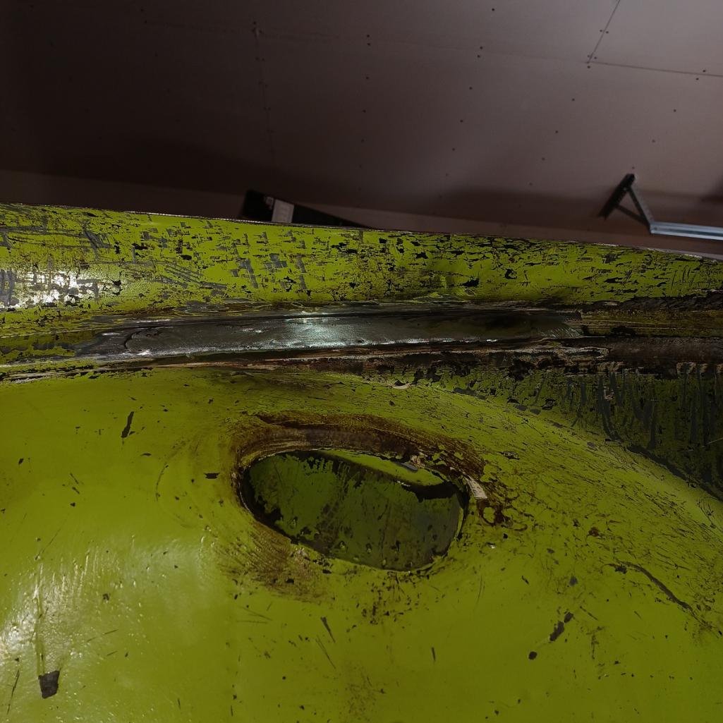

Then finished it of with a preliminary sanding and shaping, still a little touch up to do, but got frustrated with my welder becuase the wire wouldnt feed at a constant rate, so ended up with several pin holes.
