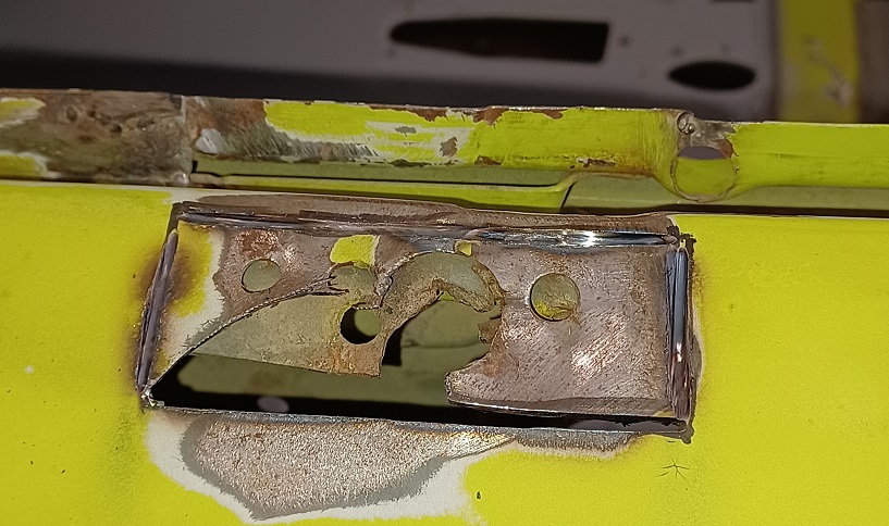

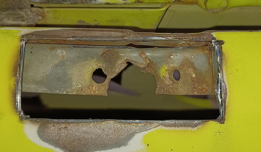

Since I couldn't figure out the welder I moved over to the drivers door. The PO had installed an adjustable mirror, but mangled the mount area in his process. (IMG:style_emoticons/default/dry.gif) So I started by cutting out the damaged sheet metal, trying not to further damage the mounting structure underneath.
Once I got that cut out I could easily see how much damage was done to the support structure for the mirror. I will try to cut out only the damaged section and re-drill and tap the mounting holes for the mirror.
