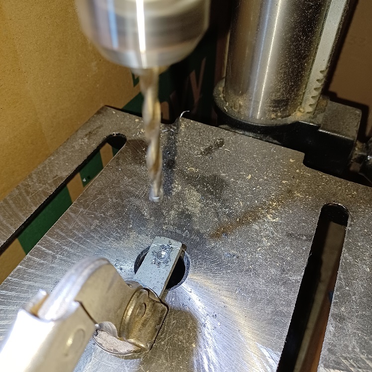

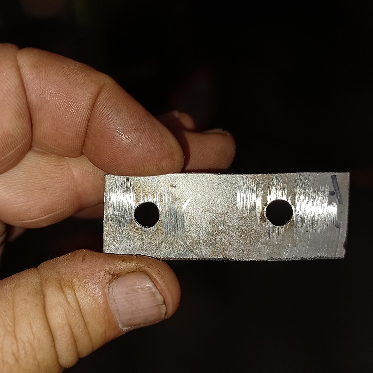

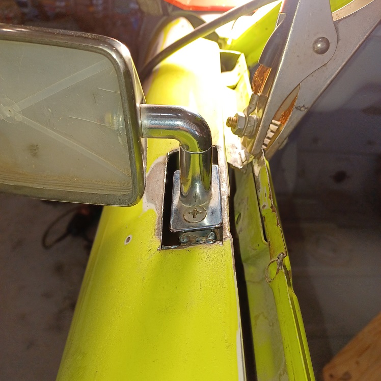

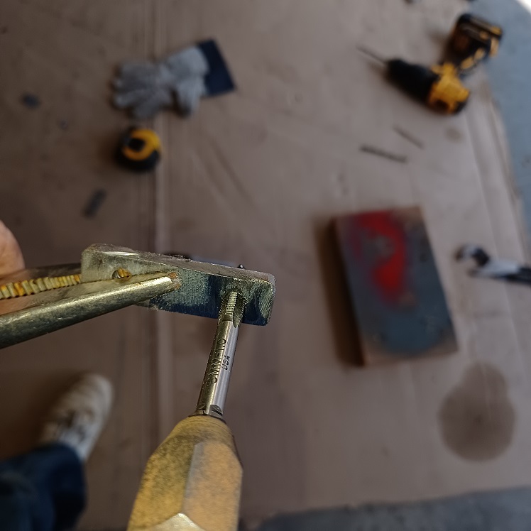

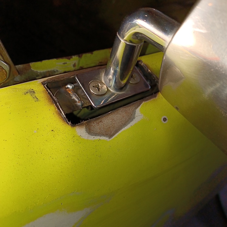

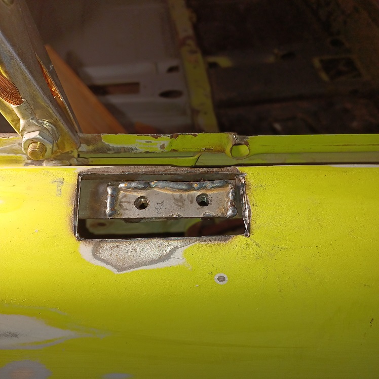

Okay, so after spending over an hour this morning trying to figure out why the welder would feed consistently, turns out the label on the wire spool started peeling away and was building up like a snowball behind the spool. Cheap and easy fix.
So I cut out the support structure for the mirror on the drivers door. As it turns out there are actually 3 layers to this part of the door. 1) the outer skin, 2) the sheet metal support, 3) the nut plate that the mirror screws into. In my case all 3 had been destroyed.
So I started by making the sheet metal support. I tried using the pieces I cut out to make the holes for the new piece and that was a mistake. They were off by about a 16th of an inch. So I grabbed an old broken mirror and made a new one using the proper measurements...
Then measured to make a new screw/nut support plate. After drilling the holes, I tapped them to fit the mounting screws for the mirror....
Then welded the screw / nut support to the sheet metal support. Then welded the sheetmetal support back into the door ....
Then double checked the allignment by attaching the mirror to the support. I am please with the allignment in the end.
Tomorrow I will weld the outer skin back onto the door.
