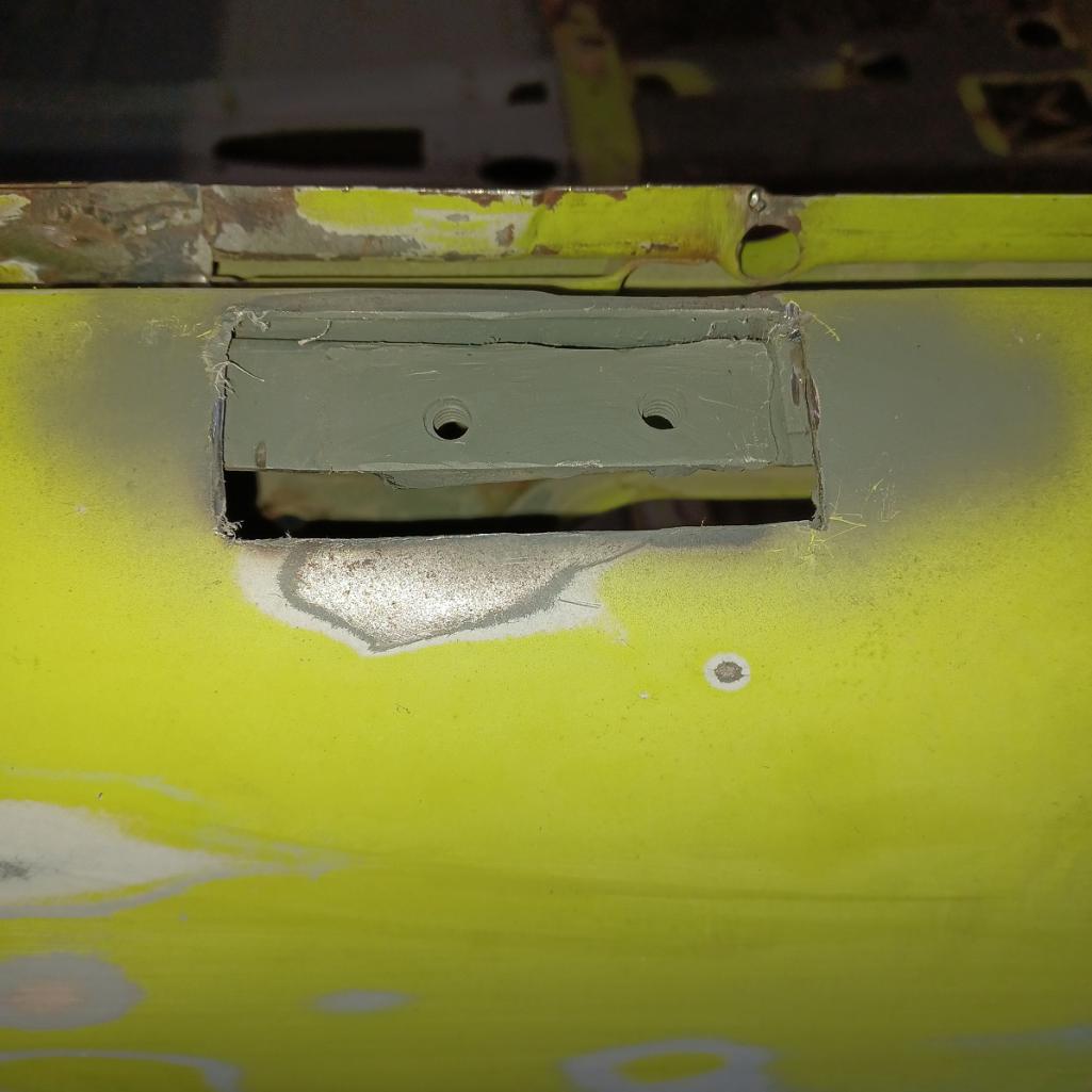

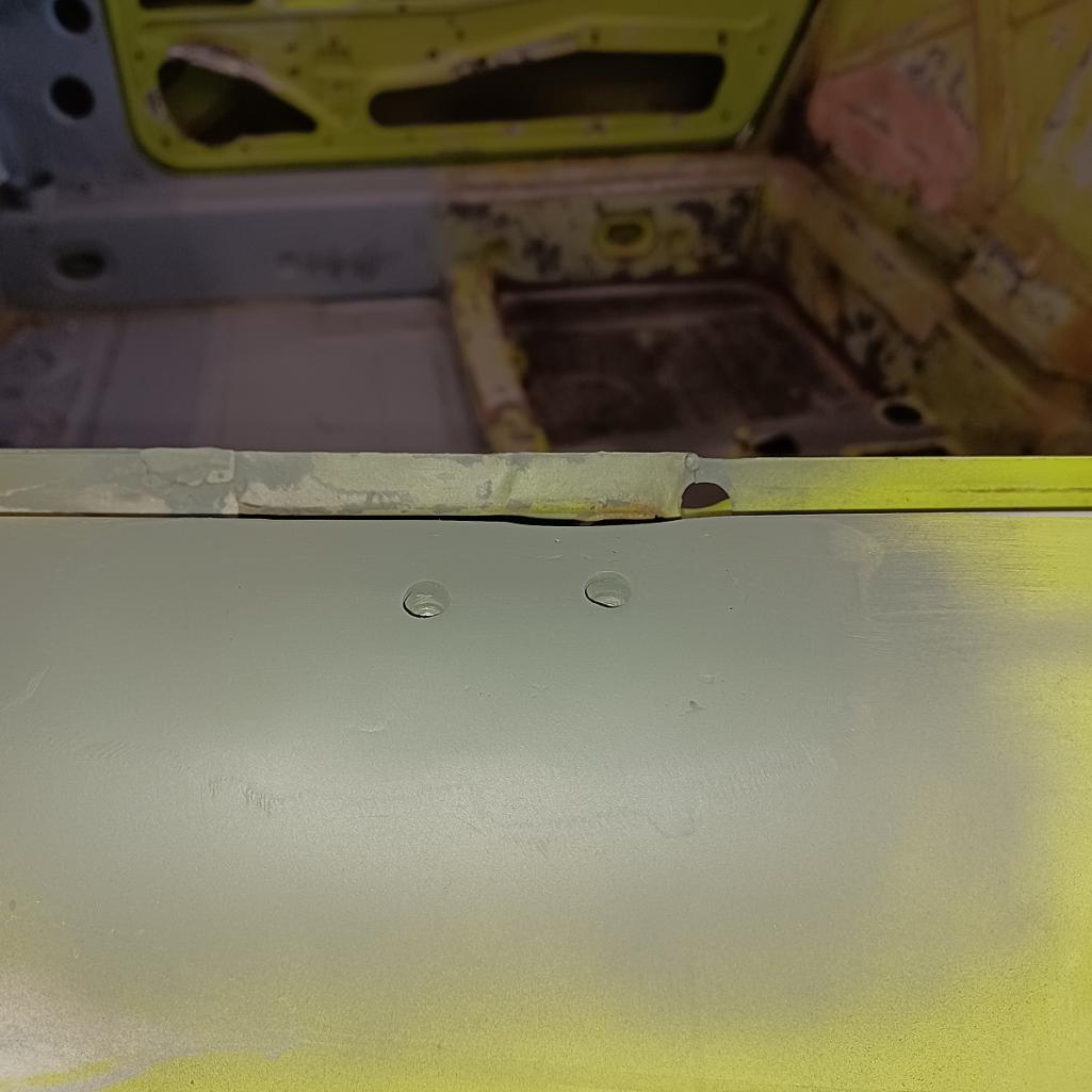

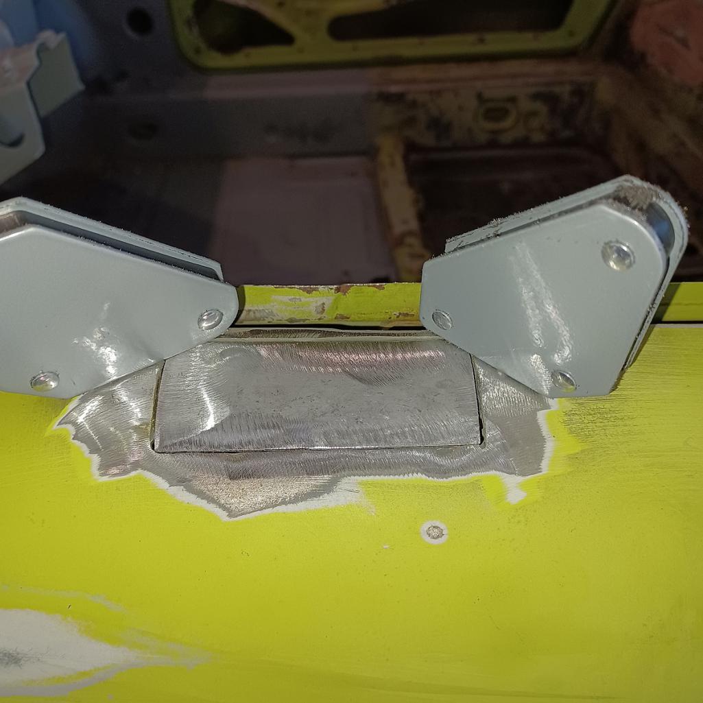

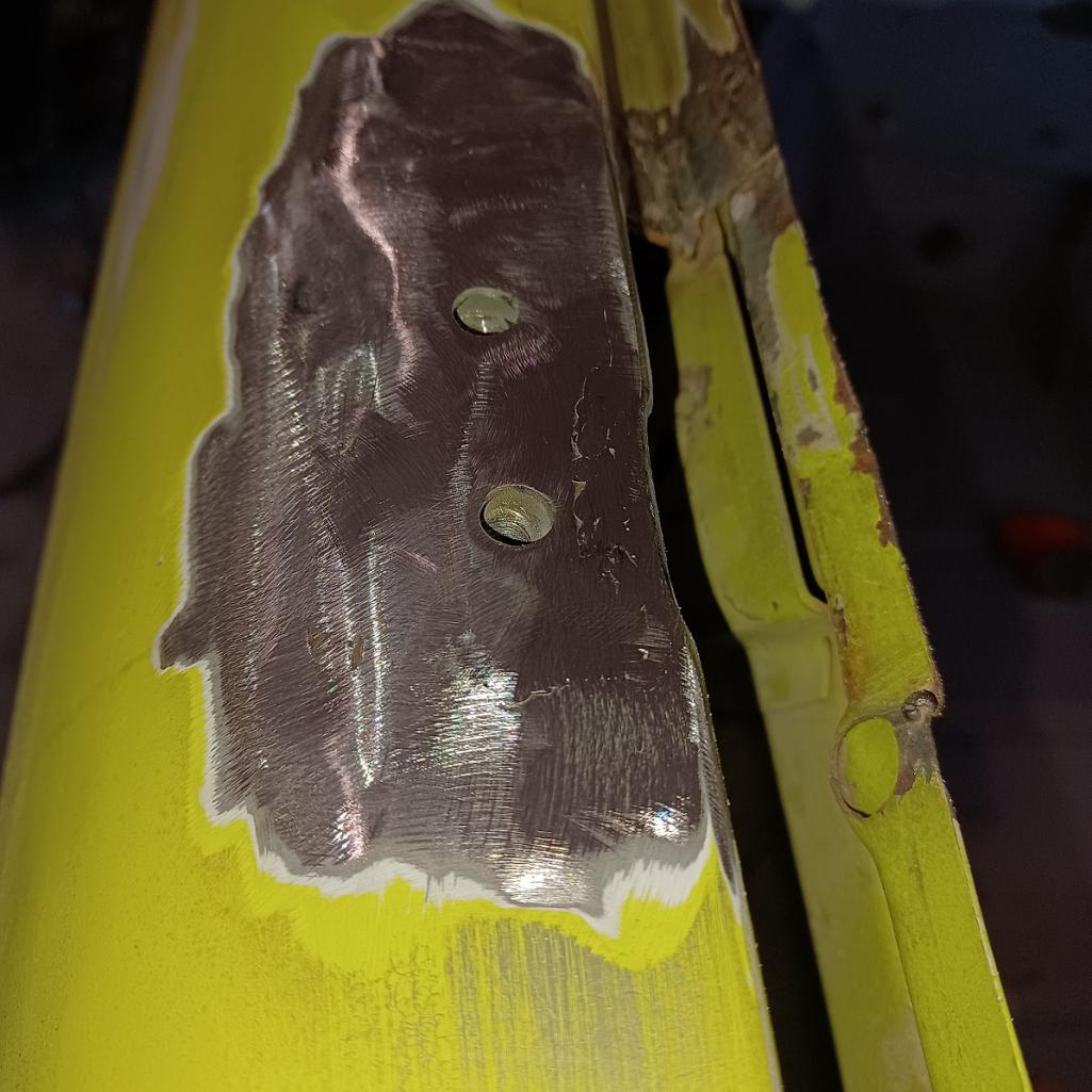

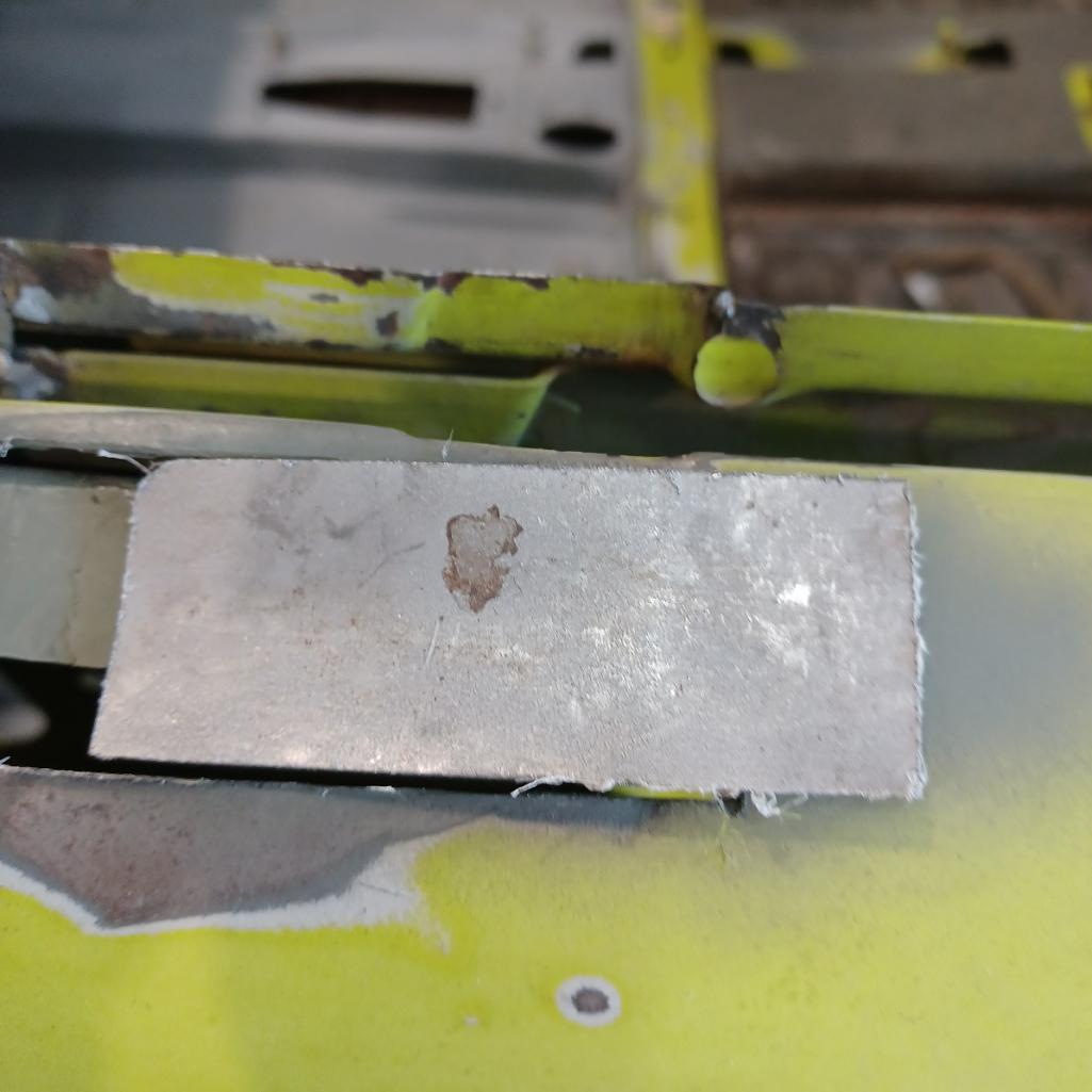

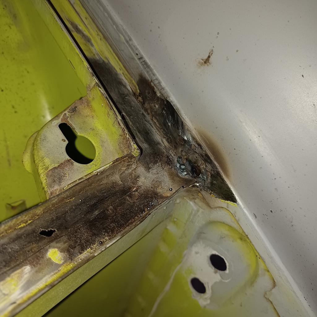

Got the support metal ground down and primed
Then cut and formed the patch piece
Checked the fit, getting the curvature correct took a bit of time, but finally got there and tacked it in
Got it all welded up and the properly aligned holes re-drilled.
And for now shot it with self etch primer. Will come back later and finish up the entire door.
Then went down and filled in the hole in the channel next to the drivers side headlight bucket.

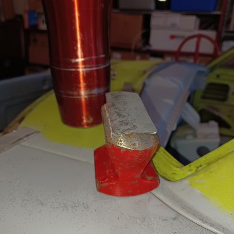

Puebloswatcop   Today I decided to work on the engine compartment ...   Oct 26 2021, 06:37 PM
Puebloswatcop   Then I went to work on the engine lid. I started ...   Oct 26 2021, 06:42 PM
Puebloswatcop   Then I drilled holes to mirror the regular screen ...   Oct 26 2021, 06:47 PM
Puebloswatcop   Then after spending the better part of an hour gri...   Oct 26 2021, 06:54 PM
Puebloswatcop   After getting what I though was a fairly good fit,...   Oct 26 2021, 07:01 PM

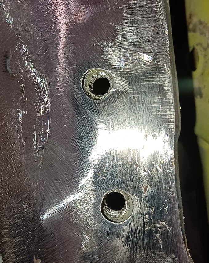

Puebloswatcop   Today started off by identifying any PO drilled ho...   Oct 27 2021, 06:42 PM
bkrantz   Today started off by identifying any PO drilled h...   Oct 27 2021, 08:00 PM
Puebloswatcop   Today started off by identifying any PO drilled ...   Oct 28 2021, 07:29 AM
Puebloswatcop   I began by forming a piece to fill the larger hole...   Oct 27 2021, 06:43 PM
Puebloswatcop   Then welded it all up to include the small hole be...   Oct 27 2021, 06:51 PM
Puebloswatcop   Then I removed the body filler that was in the low...   Oct 27 2021, 06:57 PM
Puebloswatcop   And with that I decided I was tired of trying to c...   Oct 27 2021, 07:02 PM
