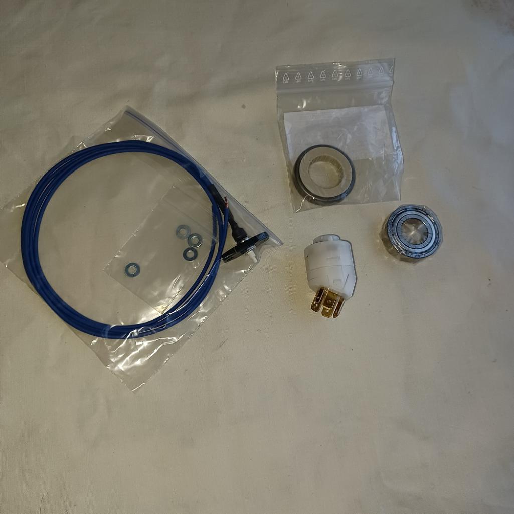

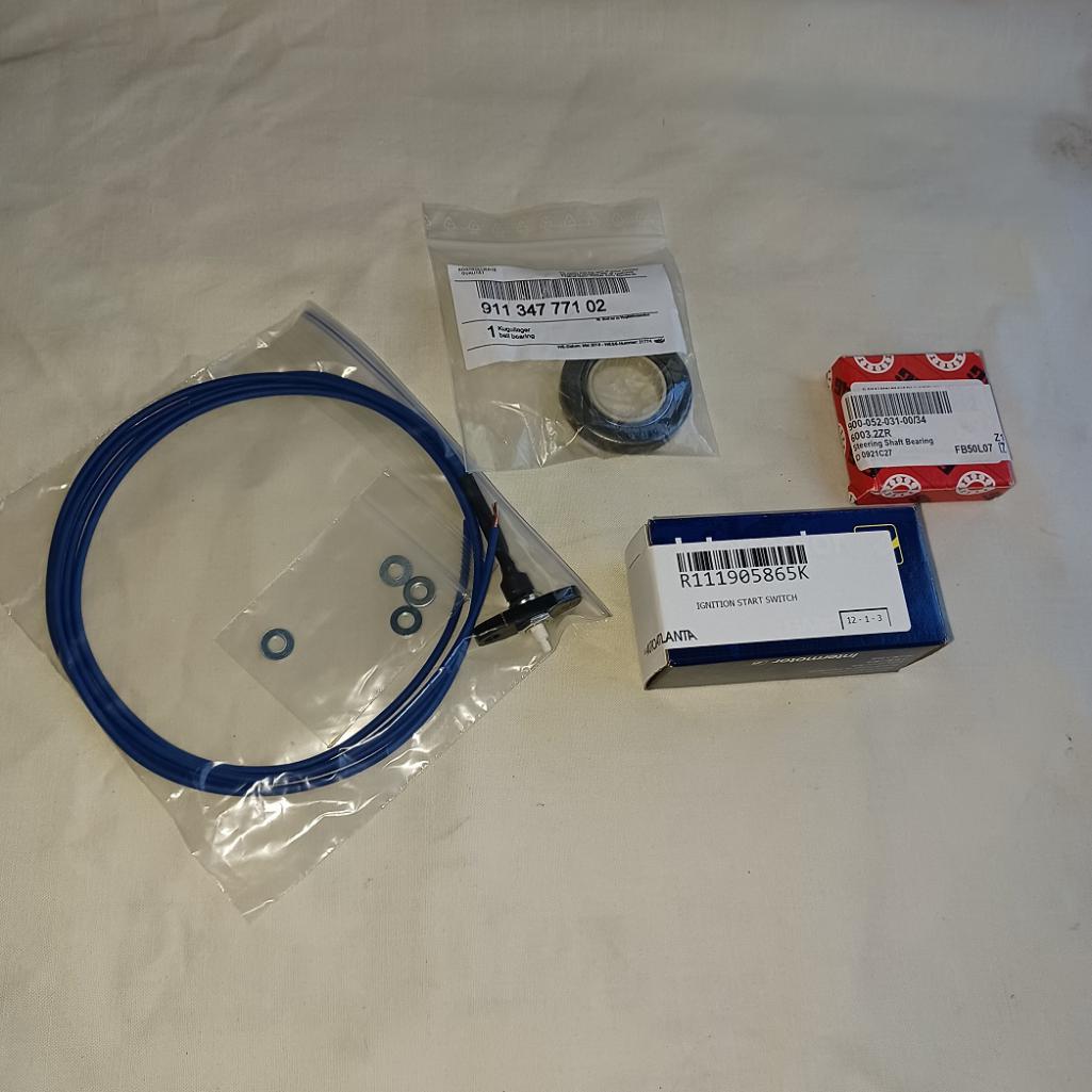

Puebloswatcop   So today I decided to take the day off from body w...   Oct 22 2021, 04:01 PM
Puebloswatcop   After laying everything out, I decided to start by...   Oct 22 2021, 04:24 PM
Puebloswatcop   From there i moved on to the ignition switch repla...   Oct 22 2021, 04:49 PM
Puebloswatcop   Since I plan on changing from a stock steering whe...   Oct 22 2021, 05:03 PM

Puebloswatcop   After completing the sub assemblies, I began assem...   Oct 22 2021, 05:42 PM
Puebloswatcop   Then it was time to re-install all of the guts. F...   Oct 22 2021, 06:10 PM
