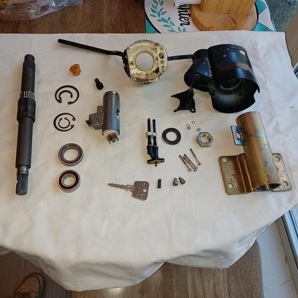

After laying everything out, I decided to start by cleaning, modifying and re-assembling all of the sub-components. I started with the modification of the windshield washer switch.

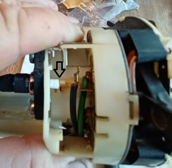

Taking the advice and experience outlined in Bob Krantz's post (Building Inside Out) I started with the Carmagic Switch (very nice product) I cut off the narrow portion of the push button in order to fit the modification method Bob used.

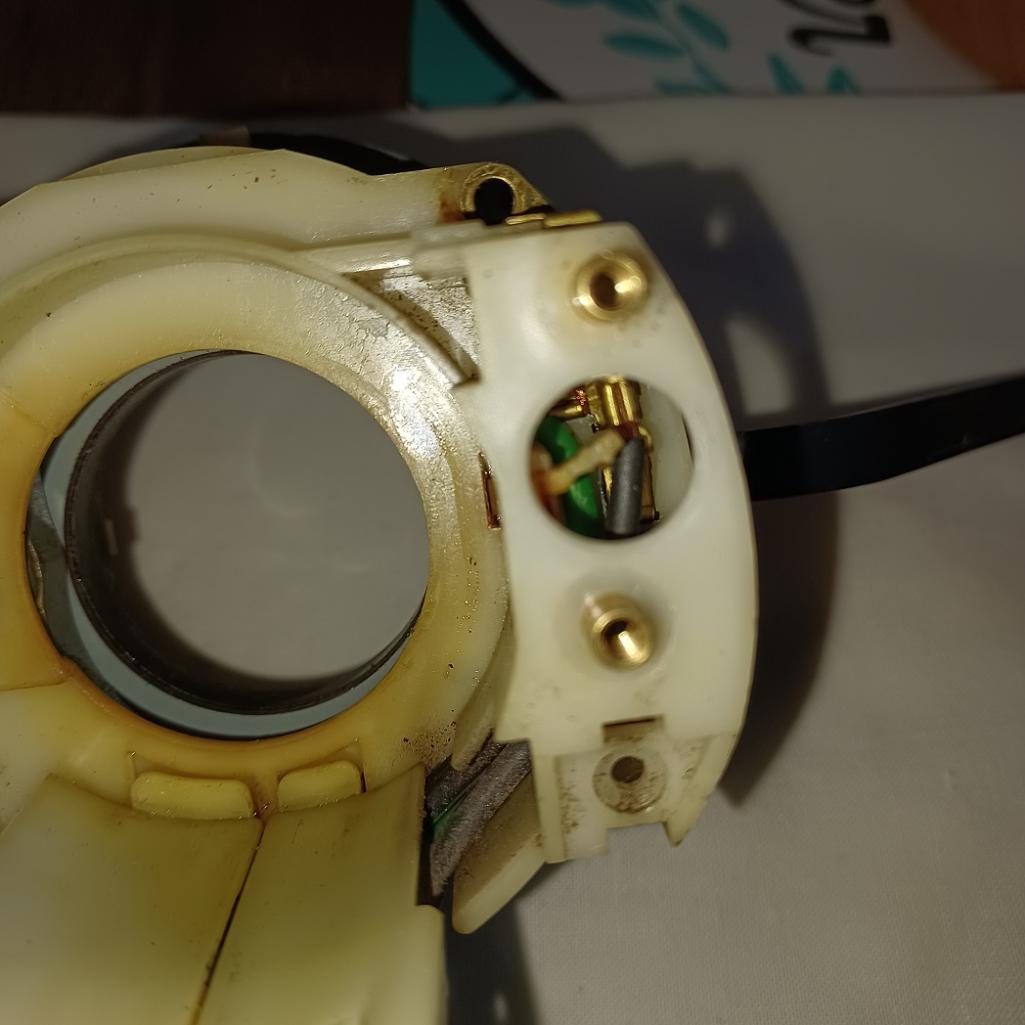

Then I drilled out the plastic mounting surface in increments until the hole was large enough to accomodate the nut for the switch mount. This ended up being a 7/16 inch hole. Be very careful when drilling so you don't break the activating tab.

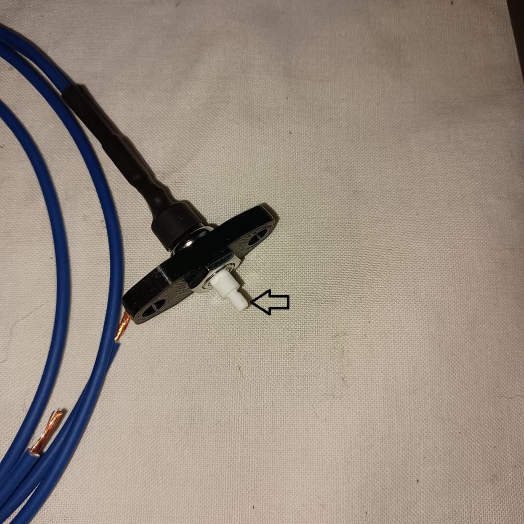

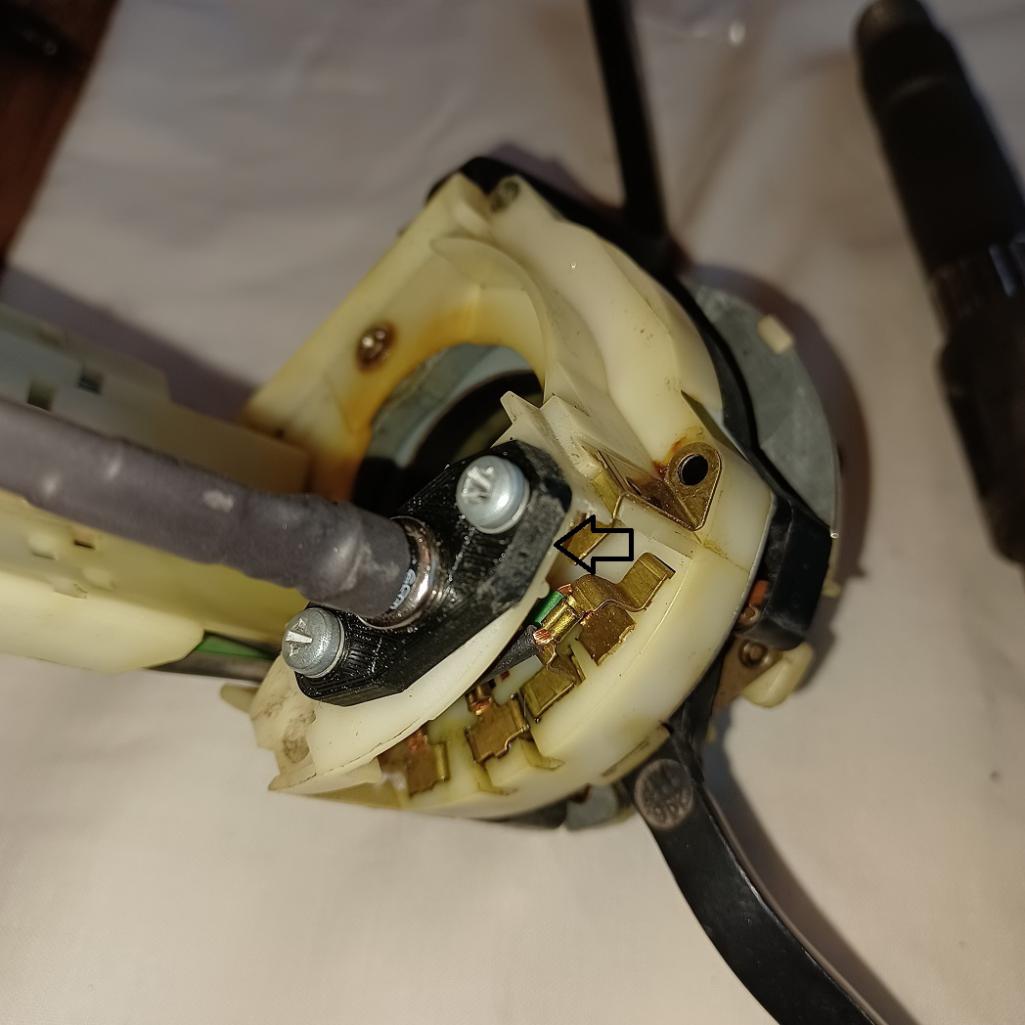

Then mounted the switch where the old fluid switch used to reside. As bob stated in his post the mount for the new switch stuck out a little past the mounting surface of the original switch mechanism, so I borrowed my wifes emory board and sanded it down till it matched (hope she doesnt find out).
By using Bob's method I found the mounting to be a bit more sucure IMO.
