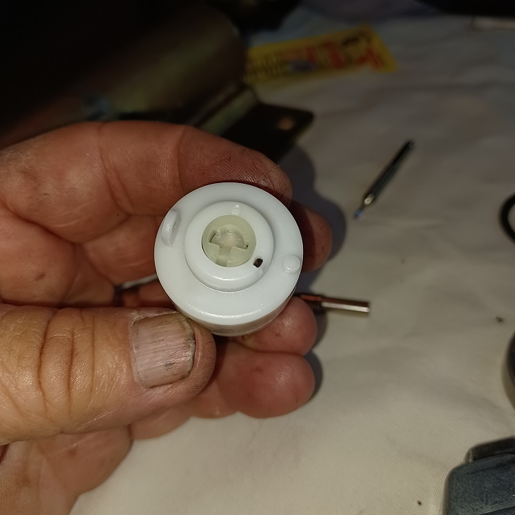

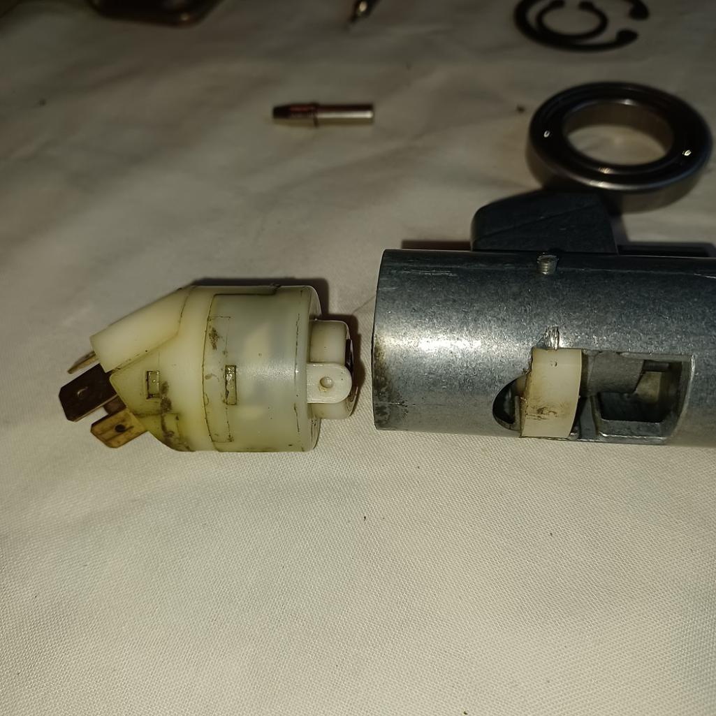

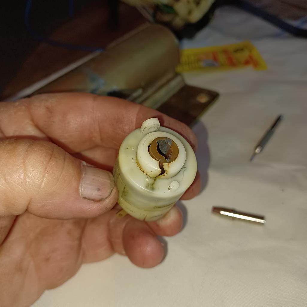

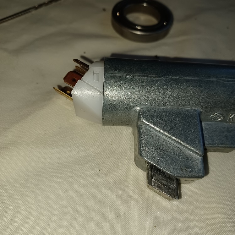

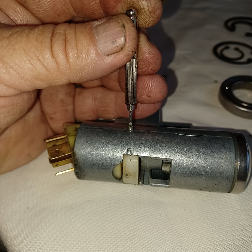

From there i moved on to the ignition switch replacement. As with many of these old cars the switch was cracked so I replaced it with a fresh part. For those who have never done this it really is a pretty simple straight forward procedure.
You simple unscrew the tiny set screw on the side of the ignition unit, remove the old switch and insert the new one, then screw the set screw back in place. The good thing is it will only go in one way.
