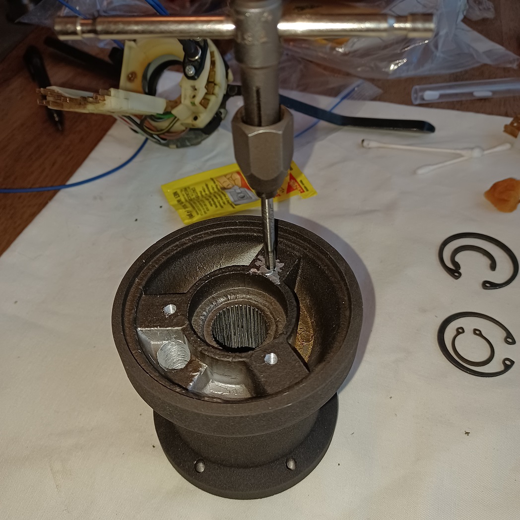

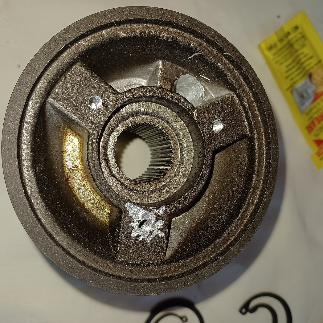

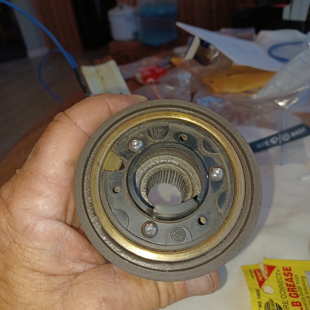

Since I plan on changing from a stock steering wheel to a Momo, I went ahead and set up the adapter. The part number I used was a Momo 8002, solid mount.
Momo sends the unit with all predrilled holes, and sheet metal screws to screw on the horn ring. I had planned on using the mounting screws from the original steering wheel to mount the ring, but they are like a 3.5 mm screw and I could not locate the proper tap, so I re-drilled the original holes and tapped them to fit a 4 mm x .7 x 10 mm screw. I had to drill out the holes in the horn ring a tiny bit but everything lined up great

Puebloswatcop   Since I plan on changing from a stock steering whe...   Oct 22 2021, 05:03 PM
