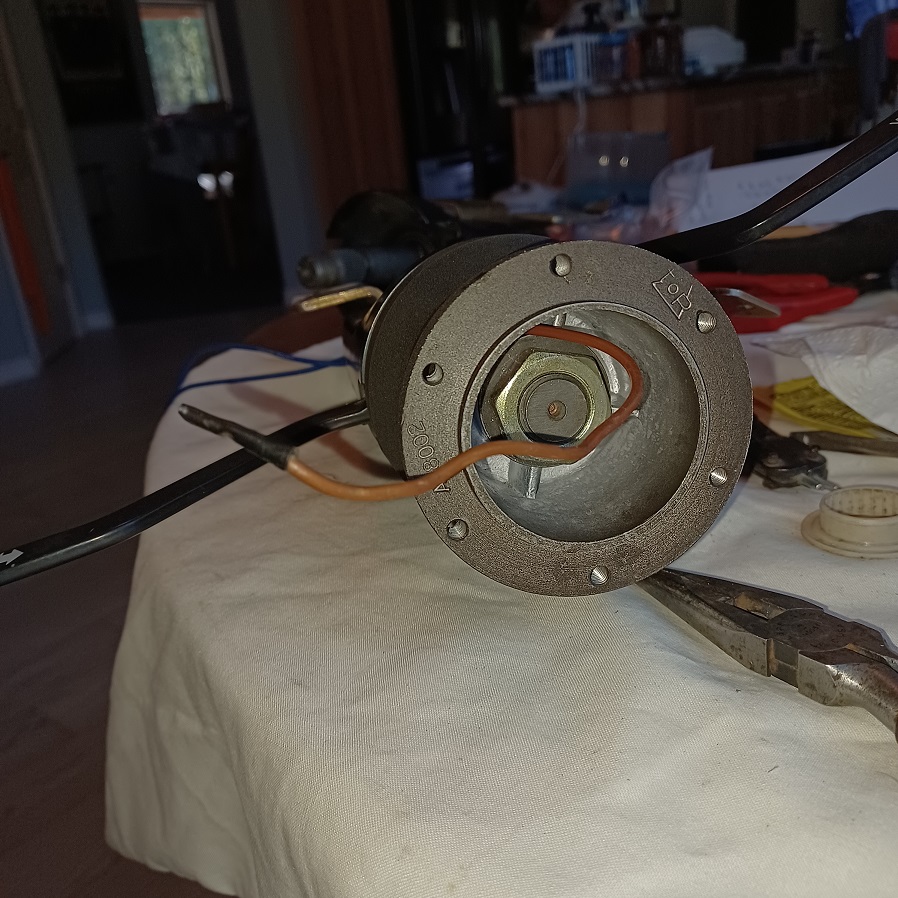

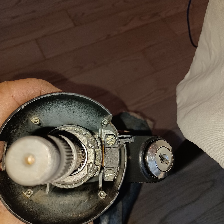

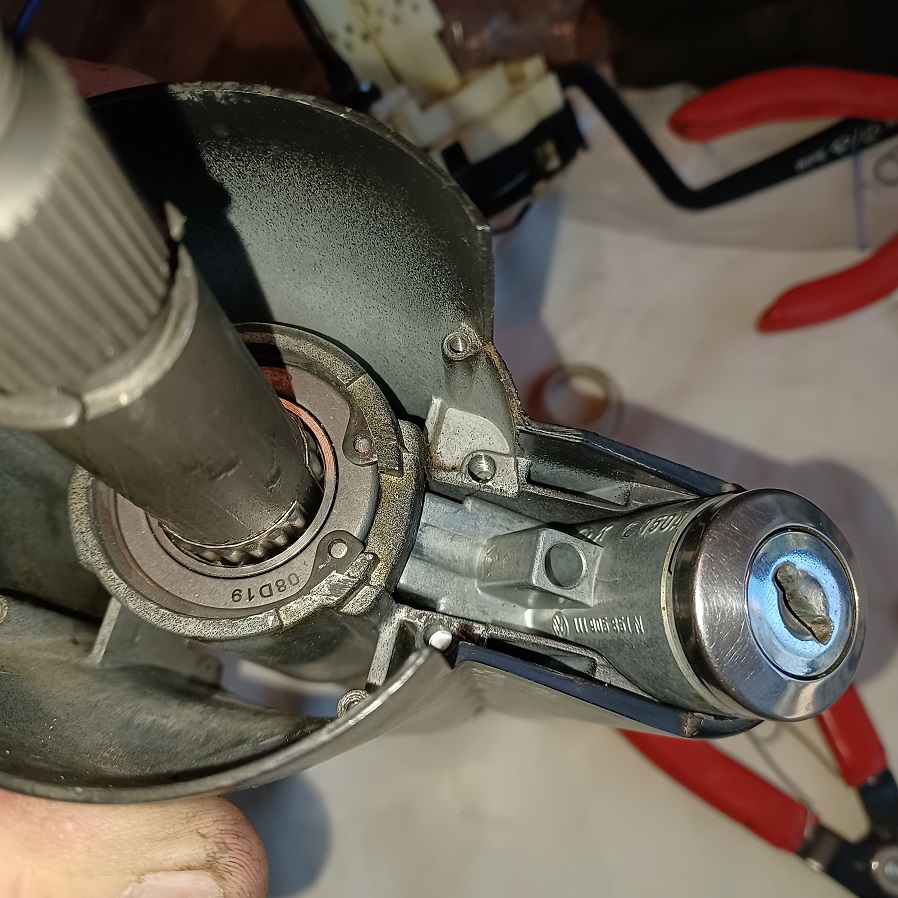

Puebloswatcop   From there i moved on to the ignition switch repla...   Oct 22 2021, 04:49 PM

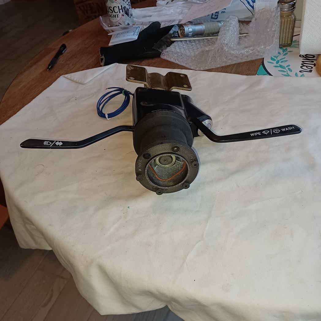

Puebloswatcop   Since I plan on changing from a stock steering whe...   Oct 22 2021, 05:03 PM
autopro   I wasn't aware of that wiper switch modificati...   Oct 22 2021, 05:23 PM
Puebloswatcop   I wasn't aware of that wiper switch modificat...   Oct 22 2021, 06:21 PM
Puebloswatcop   After completing the sub assemblies, I began assem...   Oct 22 2021, 05:42 PM
Puebloswatcop   Then it was time to re-install all of the guts. F...   Oct 22 2021, 06:10 PM
