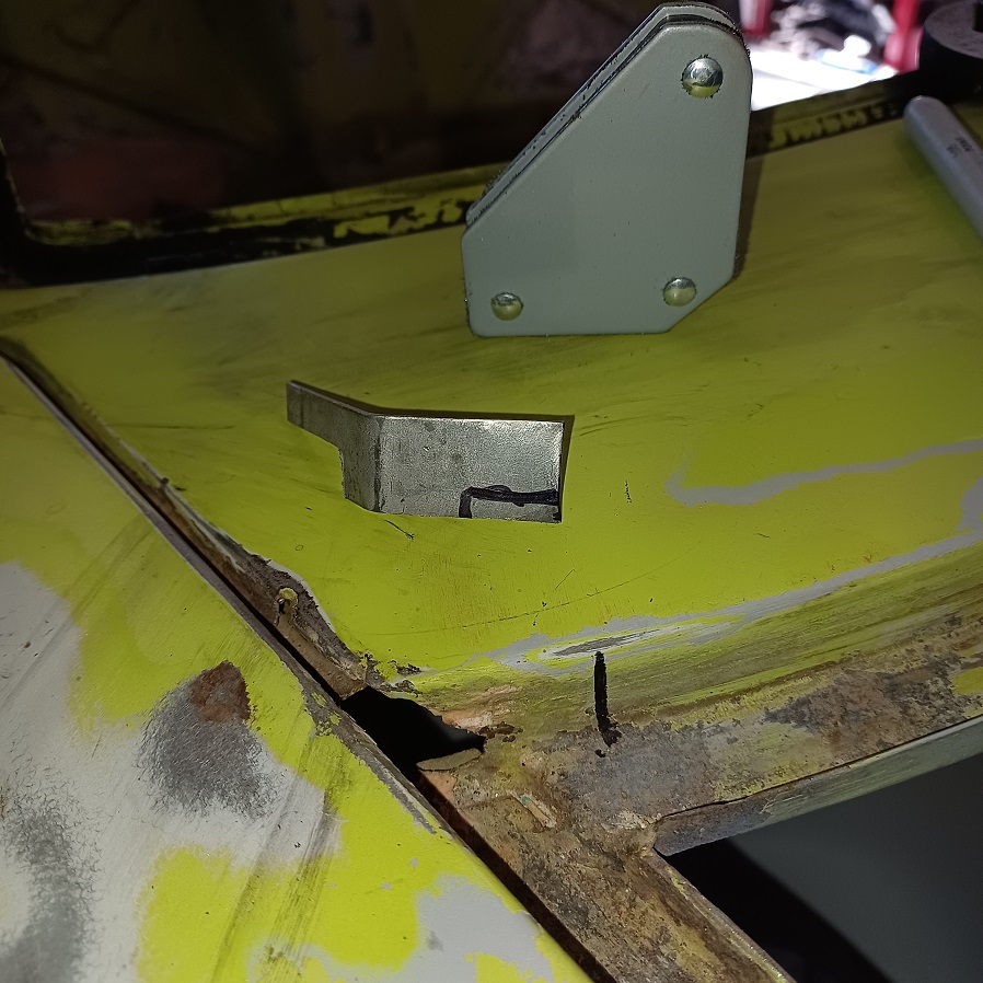

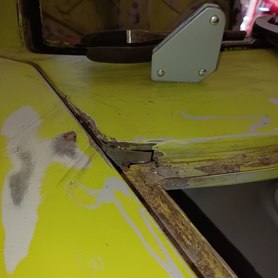

Puebloswatcop   Then moved on to the rust along the drivers side f...   Oct 19 2021, 08:20 PM
Puebloswatcop   Since I couldn't figure out the welder I moved...   Oct 19 2021, 08:26 PM

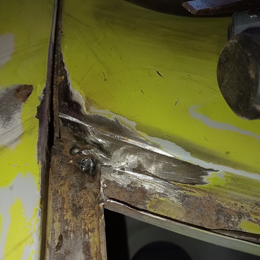

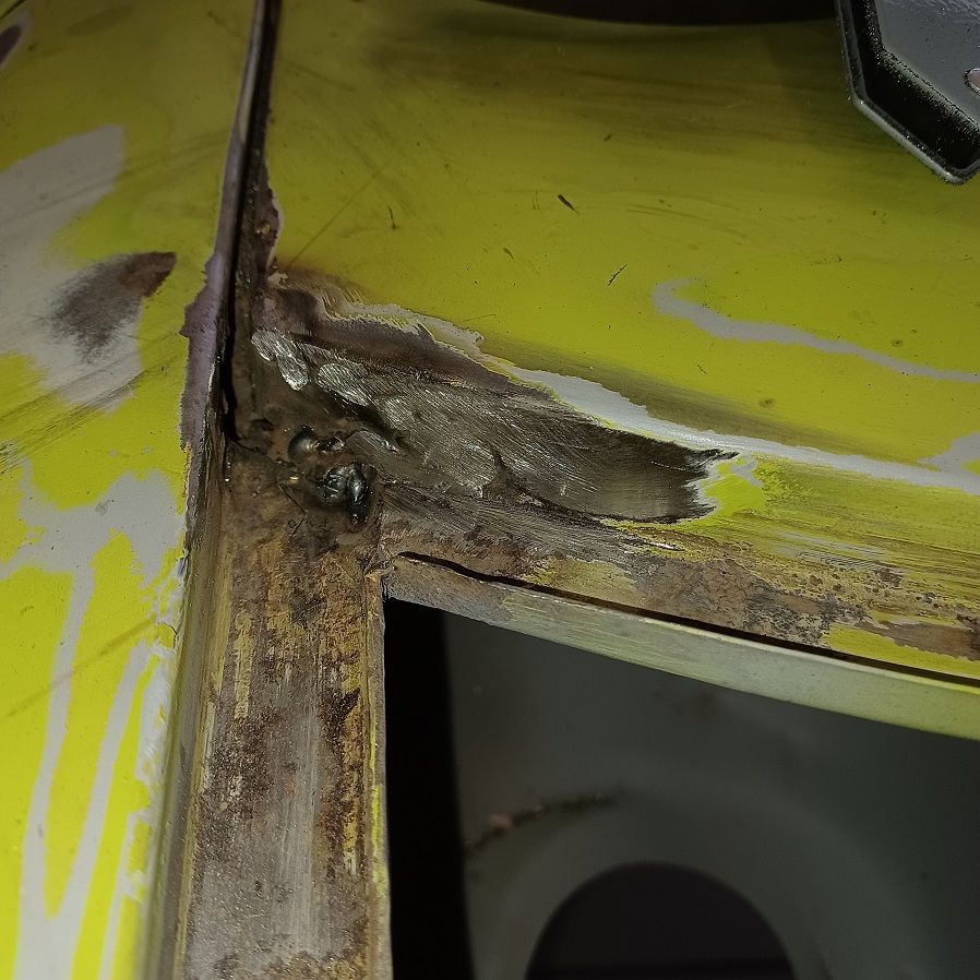

Puebloswatcop   Okay, so after spending over an hour this morning ...   Oct 20 2021, 04:50 PM
Literati914   Nice job, keep it up.. .   Oct 20 2021, 06:59 PM
Puebloswatcop   Got the support metal ground down and primed Th...   Oct 22 2021, 08:16 AM
