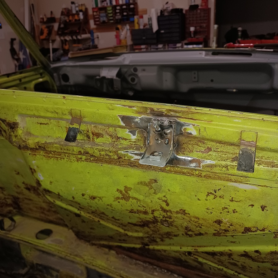

Puebloswatcop   So today it was nice enough to park the hot rod ou...   Oct 19 2021, 07:57 PM
Puebloswatcop   Then moved on to the rust along the drivers side f...   Oct 19 2021, 08:20 PM
Puebloswatcop   Since I couldn't figure out the welder I moved...   Oct 19 2021, 08:26 PM
Puebloswatcop   Okay, so after spending over an hour this morning ...   Oct 20 2021, 04:50 PM

Puebloswatcop   I began by forming a piece to fill the larger hole...   Oct 27 2021, 06:43 PM
Puebloswatcop   Then welded it all up to include the small hole be...   Oct 27 2021, 06:51 PM
