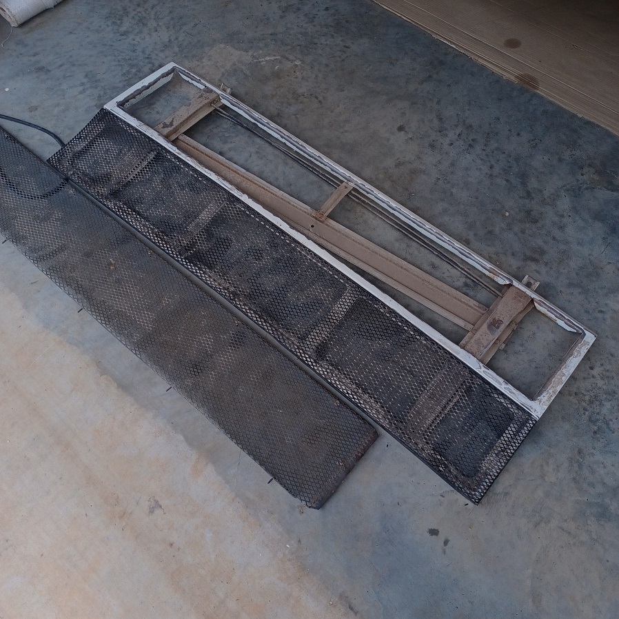

Then I went to work on the engine lid. I started working on this about 2 yers ago. My goal was to create something similar to the GT lid, only leaving more of the frame intact for rigidity. So I took an extra lid that I had and cut the solid portion out to about 1 inch smaller than the screen. Then spent hours bending the lip down so the screen would fit.
So today I decided to go back to work and get the screen properly fit.

Puebloswatcop   Today I decided to work on the engine compartment ...   Oct 26 2021, 06:37 PM
Puebloswatcop   Then I went to work on the engine lid. I started ...   Oct 26 2021, 06:42 PM
Puebloswatcop   Then I drilled holes to mirror the regular screen ...   Oct 26 2021, 06:47 PM
Puebloswatcop   Then after spending the better part of an hour gri...   Oct 26 2021, 06:54 PM
Puebloswatcop   After getting what I though was a fairly good fit,...   Oct 26 2021, 07:01 PM
