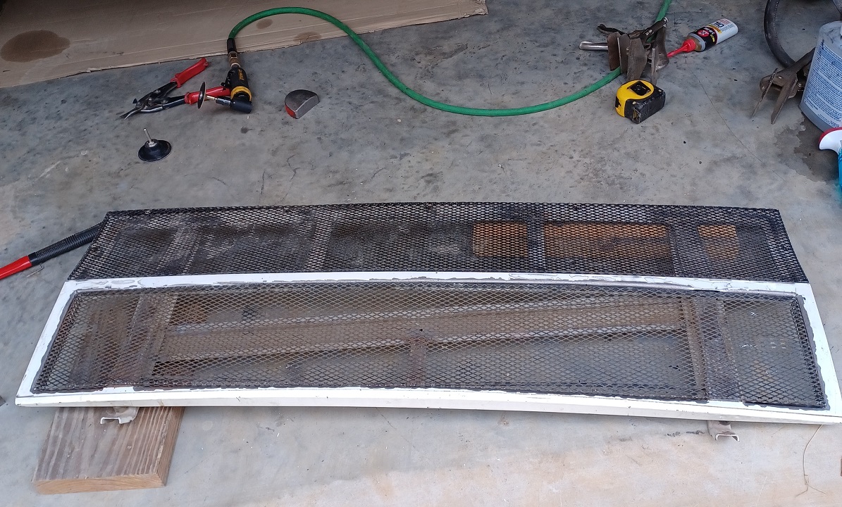

Then after spending the better part of an hour grinding off the remnants of the welds from the screen, I began to shape it to fit the cut out in the lid. Since I don't have access to a metal break, I used two pices of sharp edged wood and slowly hammered the bend on the front edge and sides.

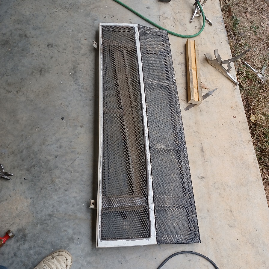

Puebloswatcop   Today I decided to work on the engine compartment ...   Oct 26 2021, 06:37 PM

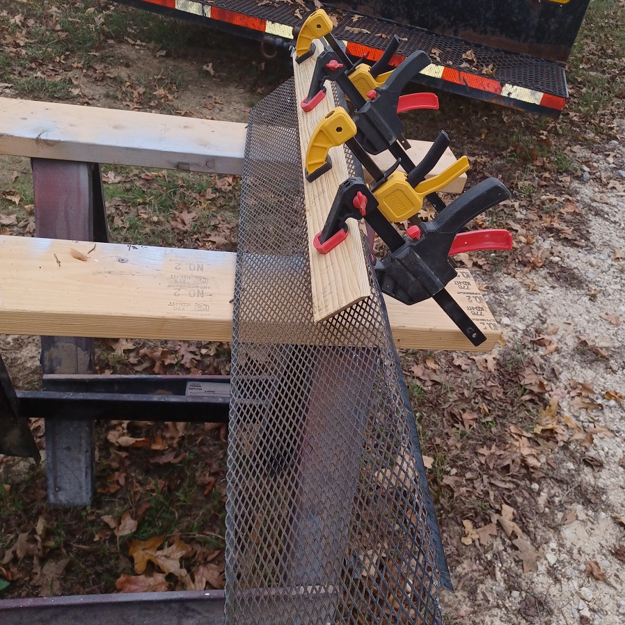

Puebloswatcop   Then I went to work on the engine lid. I started ...   Oct 26 2021, 06:42 PM
Puebloswatcop   Then I drilled holes to mirror the regular screen ...   Oct 26 2021, 06:47 PM
Puebloswatcop   Then after spending the better part of an hour gri...   Oct 26 2021, 06:54 PM
Puebloswatcop   After getting what I though was a fairly good fit,...   Oct 26 2021, 07:01 PM
