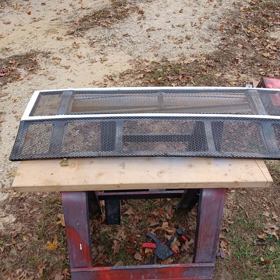

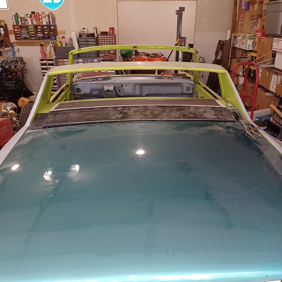

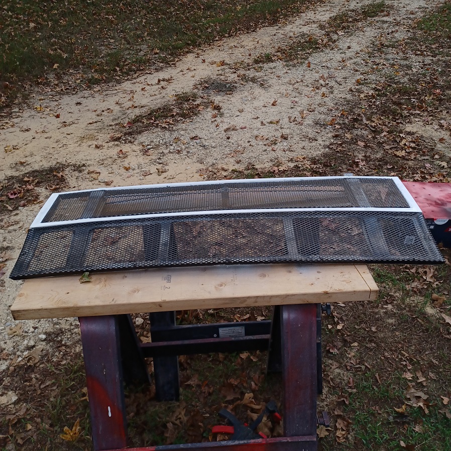

Puebloswatcop   Today I decided to work on the engine compartment ...   Oct 26 2021, 06:37 PM
Puebloswatcop   Then I went to work on the engine lid. I started ...   Oct 26 2021, 06:42 PM
Puebloswatcop   Then I drilled holes to mirror the regular screen ...   Oct 26 2021, 06:47 PM
Puebloswatcop   Then after spending the better part of an hour gri...   Oct 26 2021, 06:54 PM
Puebloswatcop   After getting what I though was a fairly good fit,...   Oct 26 2021, 07:01 PM
