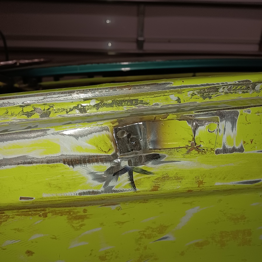

Puebloswatcop
post Oct 27 2021, 06:51 PM
Posts: 1,782
Joined: 27-December 14
From: Mineola, Texas
Member No.: 18,258

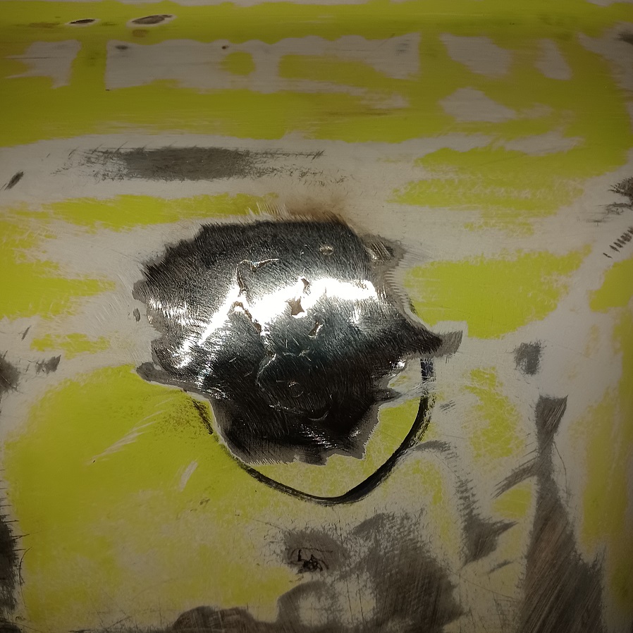

Then welded it all up to include the small hole below the large one.
Then filled in the hole from the hinge bolt

Puebloswatcop   I began by forming a piece to fill the larger hole...   Oct 27 2021, 06:43 PM
Puebloswatcop   Then welded it all up to include the small hole be...   Oct 27 2021, 06:51 PM
Puebloswatcop   Then I removed the body filler that was in the low...   Oct 27 2021, 06:57 PM
