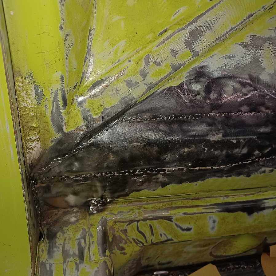

Puebloswatcop
post Oct 27 2021, 06:57 PM
Posts: 1,782
Joined: 27-December 14
From: Mineola, Texas
Member No.: 18,258
Then I removed the body filler that was in the lower wall on the passenger side, afraid of what I might find. I was pleasantly surprised to find a half decent repair, probably as a result of battery rust in the hell hole, but insted of using seam filler, they used body filler to cover it up. It needs some touch up work, but it is a solid repair.

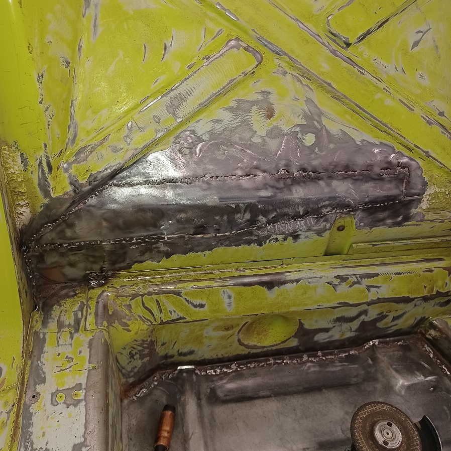

Puebloswatcop   I began by forming a piece to fill the larger hole...   Oct 27 2021, 06:43 PM
Puebloswatcop   Then welded it all up to include the small hole be...   Oct 27 2021, 06:51 PM
Puebloswatcop   Then I removed the body filler that was in the low...   Oct 27 2021, 06:57 PM
Puebloswatcop   And with that I decided I was tired of trying to c...   Oct 27 2021, 07:02 PM
