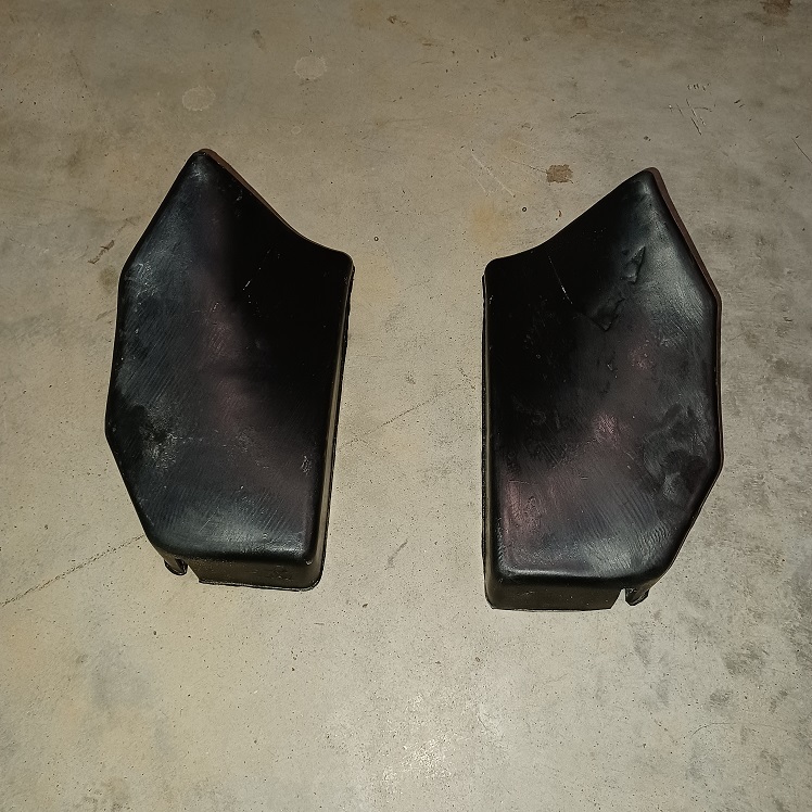

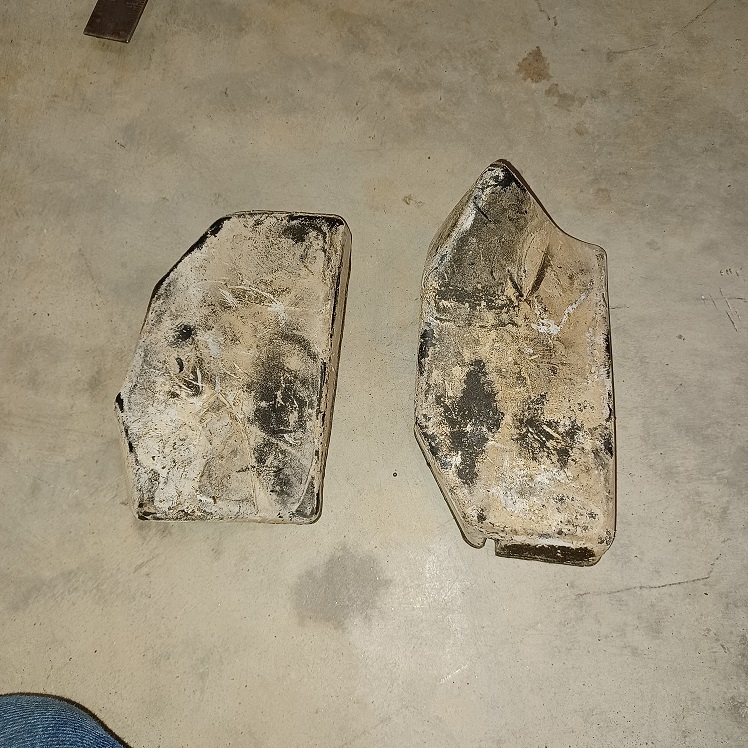

Decided to take a break from working on the body this weekend. So cleaned up a bunch of parts and re-packed them. Now they are ready for re-installation and easy to find.
The first to get a serious cleaning were the two fuel tank rubber supports...
