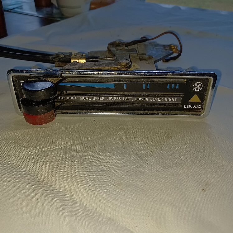

The next thing I unboxed was the climate controls. Years of grime and dirt and dried grease. Overall it was in pretty good shape though.

Puebloswatcop   The next thing I unboxed was the climate controls....   Nov 1 2021, 08:52 AM

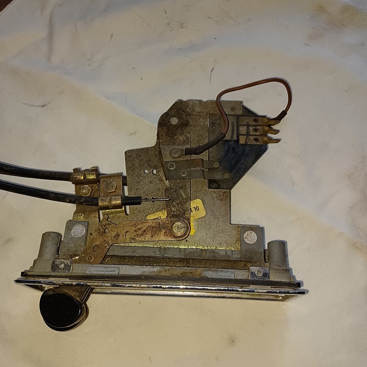

Puebloswatcop   One thing I did find is that it appears there is a...   Nov 1 2021, 08:56 AM
Puebloswatcop   So I spent about an hour dis-assembling parts of t...   Nov 1 2021, 08:59 AM
Puebloswatcop   Then re-assebled the clean product. Everything se...   Nov 1 2021, 09:02 AM
