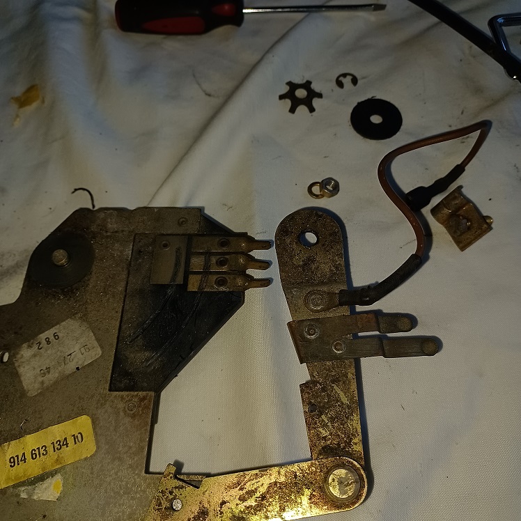

Puebloswatcop   So I spent about an hour dis-assembling parts of t...   Nov 1 2021, 08:59 AM
Puebloswatcop   Then re-assebled the clean product. Everything se...   Nov 1 2021, 09:02 AM
