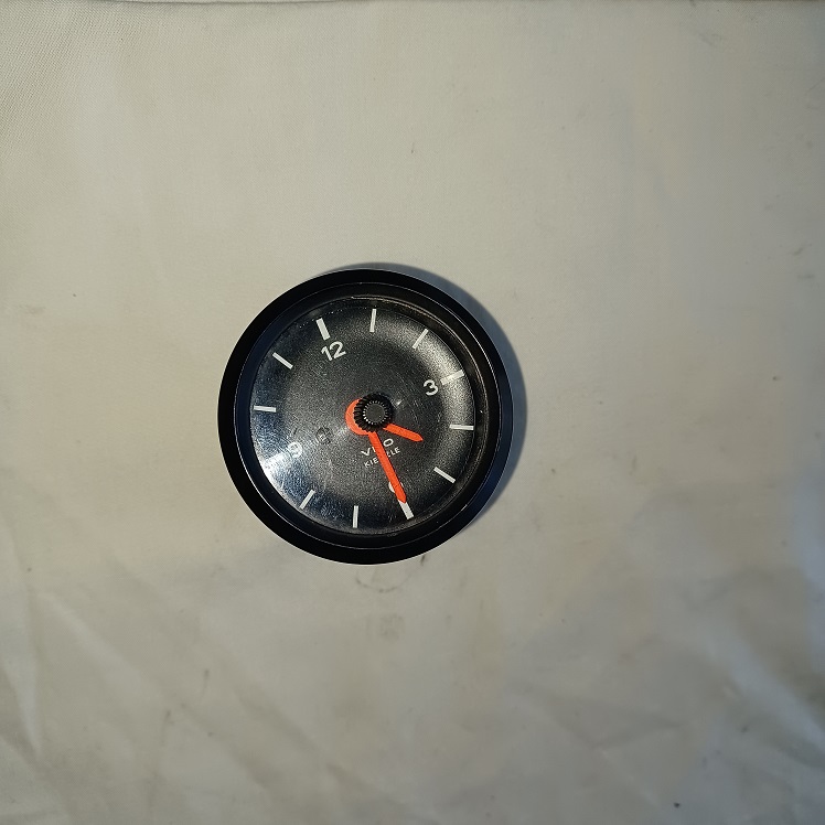

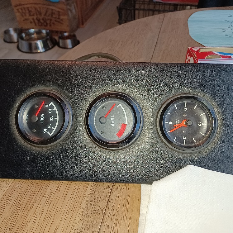

Puebloswatcop   Then cleaned and checked the center console. Hook...   Nov 1 2021, 09:14 AM
