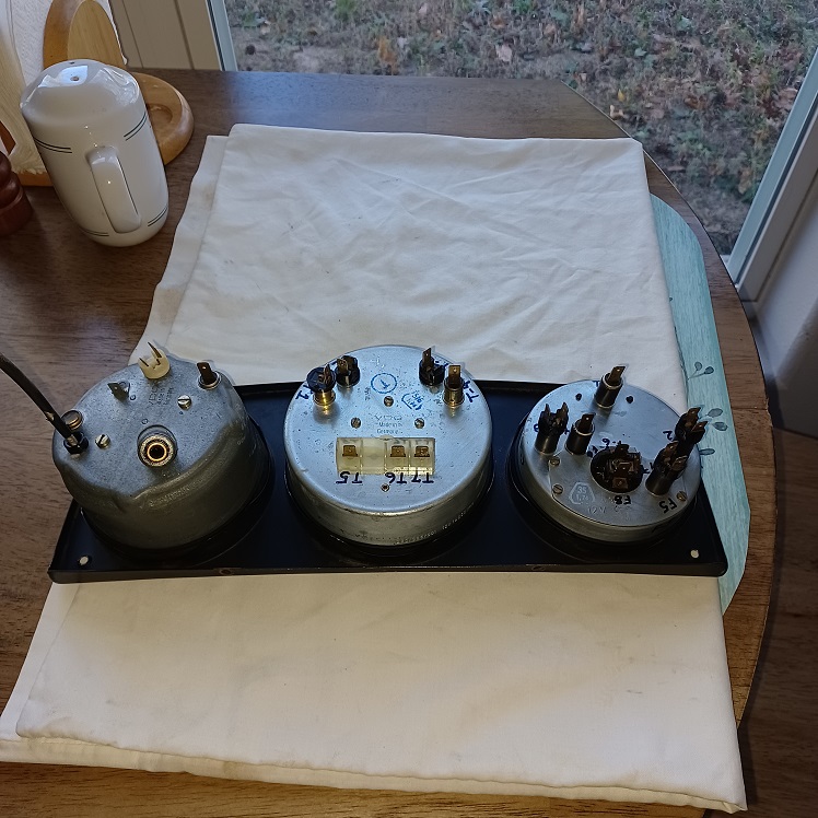

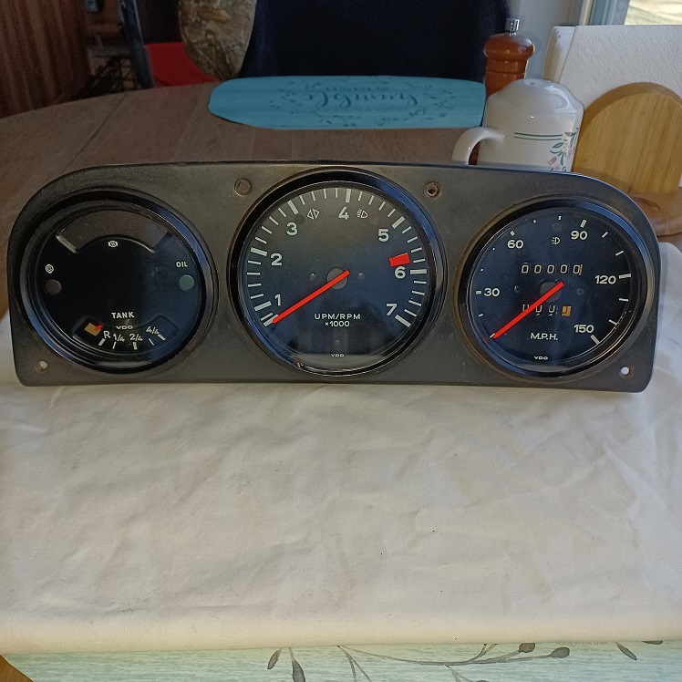

Puebloswatcop   To finish up the weekend, I cleaned the entire gua...   Nov 1 2021, 09:17 AM
