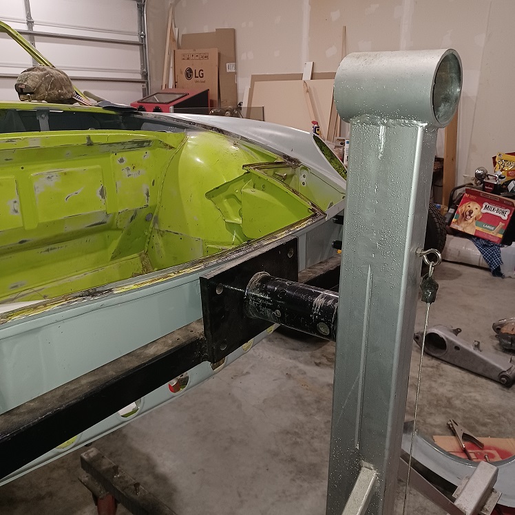

Puebloswatcop   Since today was a rainy and cold I decided to lift...   Nov 3 2021, 03:23 PM
Puebloswatcop   Only had 20 inches to get it onto the mounts   Nov 3 2021, 03:25 PM
Puebloswatcop   Then after getting it onto the rotisserie had to r...   Nov 3 2021, 03:27 PM
Puebloswatcop   And some 5 hours after starting, Its finally on th...   Nov 3 2021, 03:30 PM
