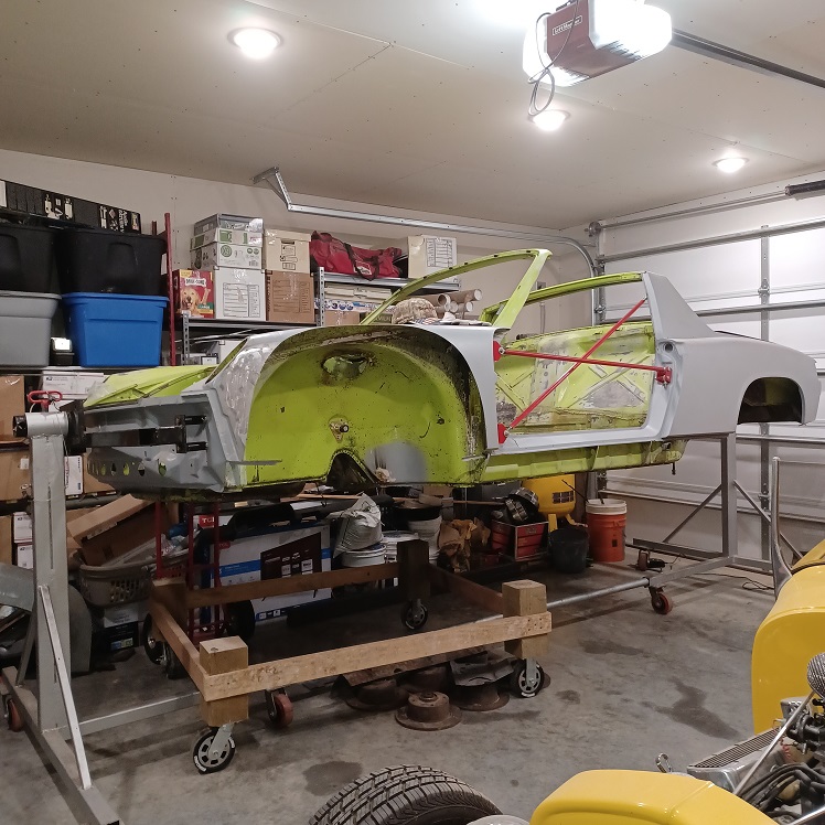

And some 5 hours after starting, Its finally on the rotisserie, a day I wasn't sure I'd ever see. (IMG:style_emoticons/default/piratenanner.gif)

QUOTE(Puebloswatcop @ Nov 3 2021, 03:30 PM) *
Now you can look forward to the day it comes off! Mine was on the rotisserie 6 months.
