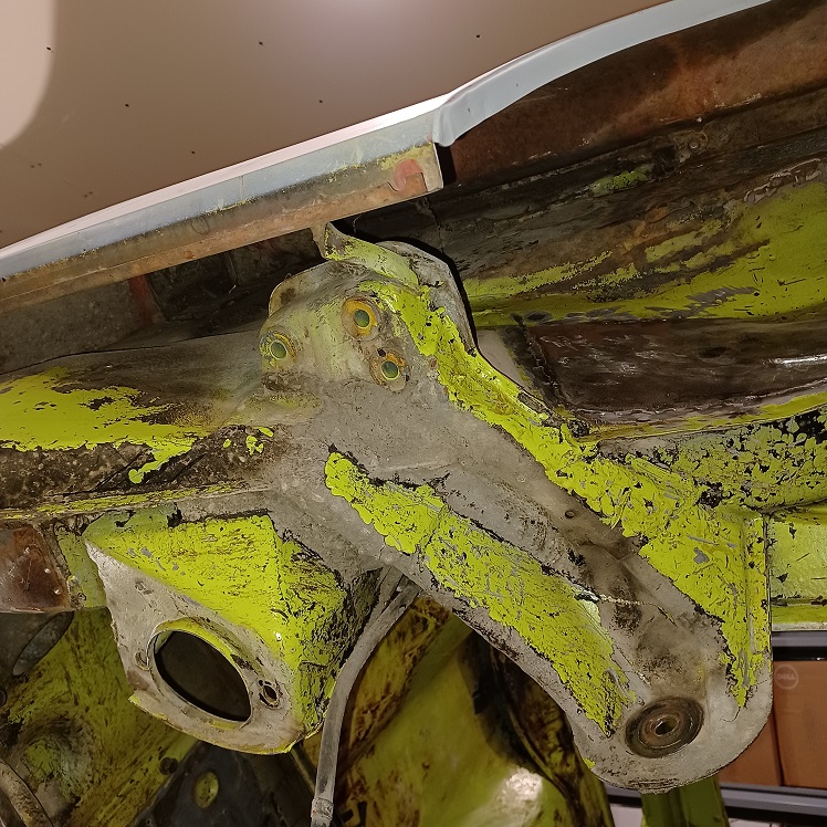

Puebloswatcop   So today was spent stripping the undercoating from...   Nov 4 2021, 04:41 PM
Puebloswatcop   At least some of it was already done, but there ar...   Nov 4 2021, 04:44 PM
Puebloswatcop   The good thing is the engine compartment is pretty...   Nov 4 2021, 04:47 PM
