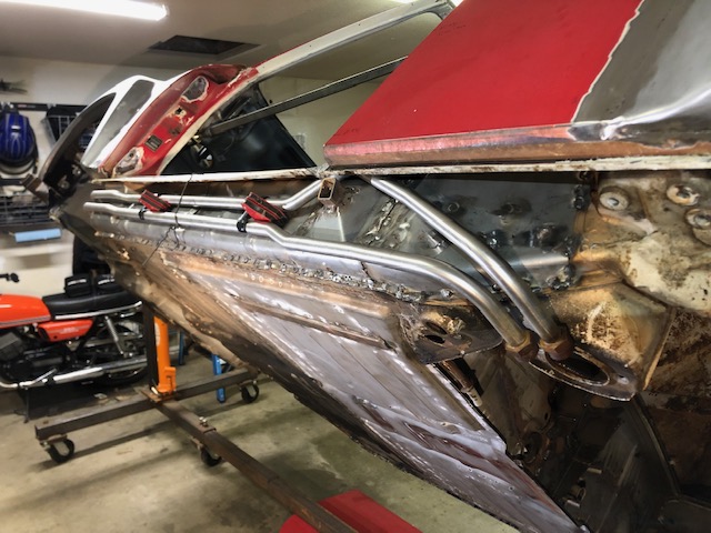

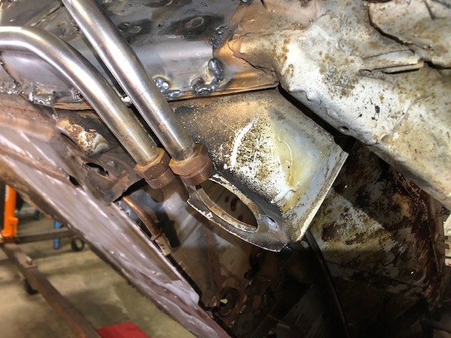

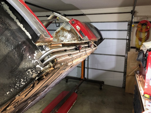

pencap914   Figuring out the oil system for the 2.7. Was on th...   Nov 7 2021, 10:22 AM
pencap914   Also working on restoring the fiberglass engine sh...   Nov 7 2021, 10:26 AM
