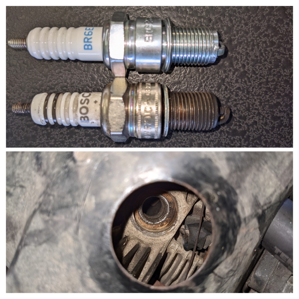

Well, now that I have four plugs that fit, the car definitely runs better. I’m still so pissed that a guy who sells himself on being a classic Porsche specialist could miss something so damn basic.

StarBear   On my 74 1.8L, I use NGK BP6ES. The BP6S are a bit...   Nov 11 2021, 03:02 PM
Van B   On my 74 1.8L, I use NGK BP6ES. The BP6S are a bi...   Nov 11 2021, 03:57 PM
