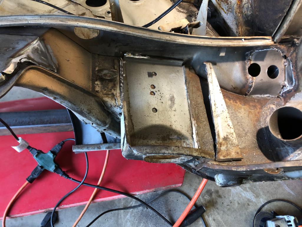

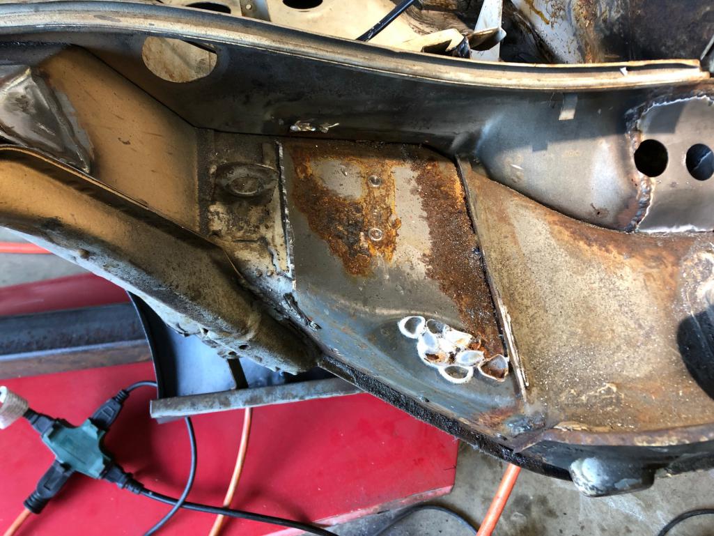

pencap914   Update: So I bought this car knowing the tub was ...   Mar 14 2021, 10:29 PM
mate914   Most all of the rear pillar strength comes from be...   Mar 15 2021, 07:27 AM
pencap914   Most all of the rear pillar strength comes from b...   Mar 15 2021, 10:15 AM
pencap914   Well, finding more issues with some of the previou...   Mar 23 2021, 11:04 PM
mate914   Well, finding more issues with some of the previo...   Mar 24 2021, 09:02 AM

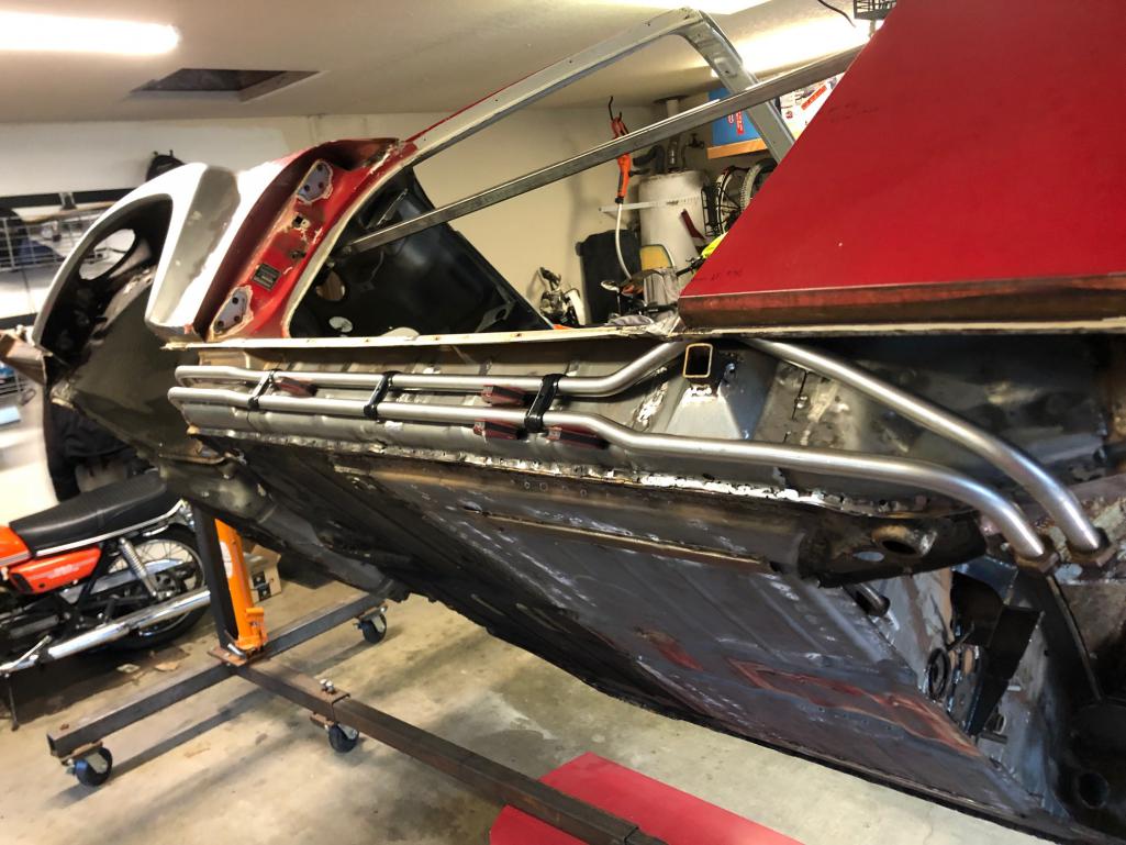

pencap914   Installed the rear suspension stiffening kit: Was ...   Sep 2 2021, 11:13 PM
pencap914   So now I have a problem to solve: What to do about...   Sep 2 2021, 11:29 PM

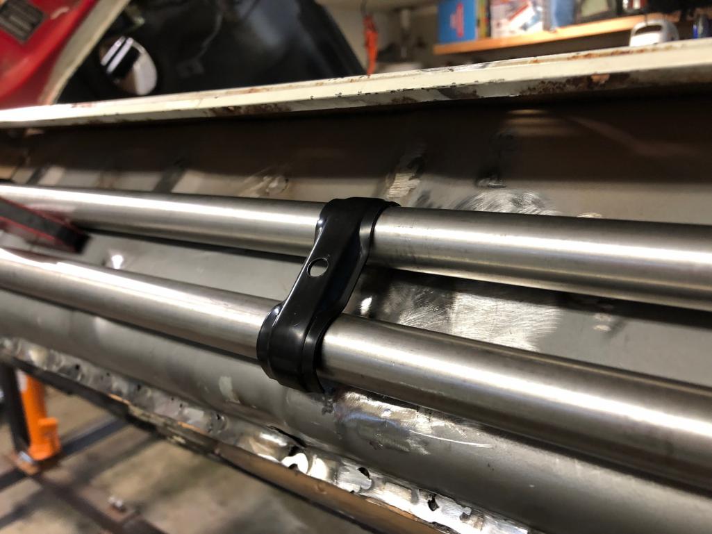

Luke M   Question on the SS oil lines going down the driver...   Nov 18 2021, 10:24 AM
pencap914   Question on the SS oil lines going down the drive...   Nov 30 2021, 05:30 PM
Luke M   Question on the SS oil lines going down the driv...   Dec 1 2021, 05:49 PM
