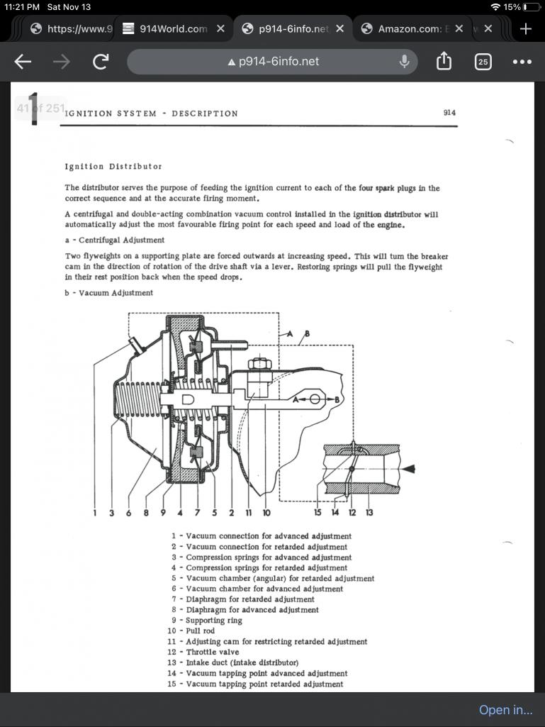

Forgot to attach this:

wonkipop   @Van B & [b]@[url=http://www.914world.com/b...   Nov 13 2021, 06:05 PM
emerygt350   You have to do the aar tests. They cost nothing a...   Nov 13 2021, 08:48 PM
wonkipop   i just did a cool start. its about 4.5 hours later...   Nov 13 2021, 09:45 PM
wonkipop   i also have just had one other thought for Van B. ...   Nov 13 2021, 10:03 PM
Van B   Lots of science going on down under today lol...   Nov 13 2021, 10:34 PM
Van B   Forgot to attach this:   Nov 13 2021, 10:56 PM
wonkipop   :) re timing. thats why i am leaving all this al...   Nov 13 2021, 11:12 PM
