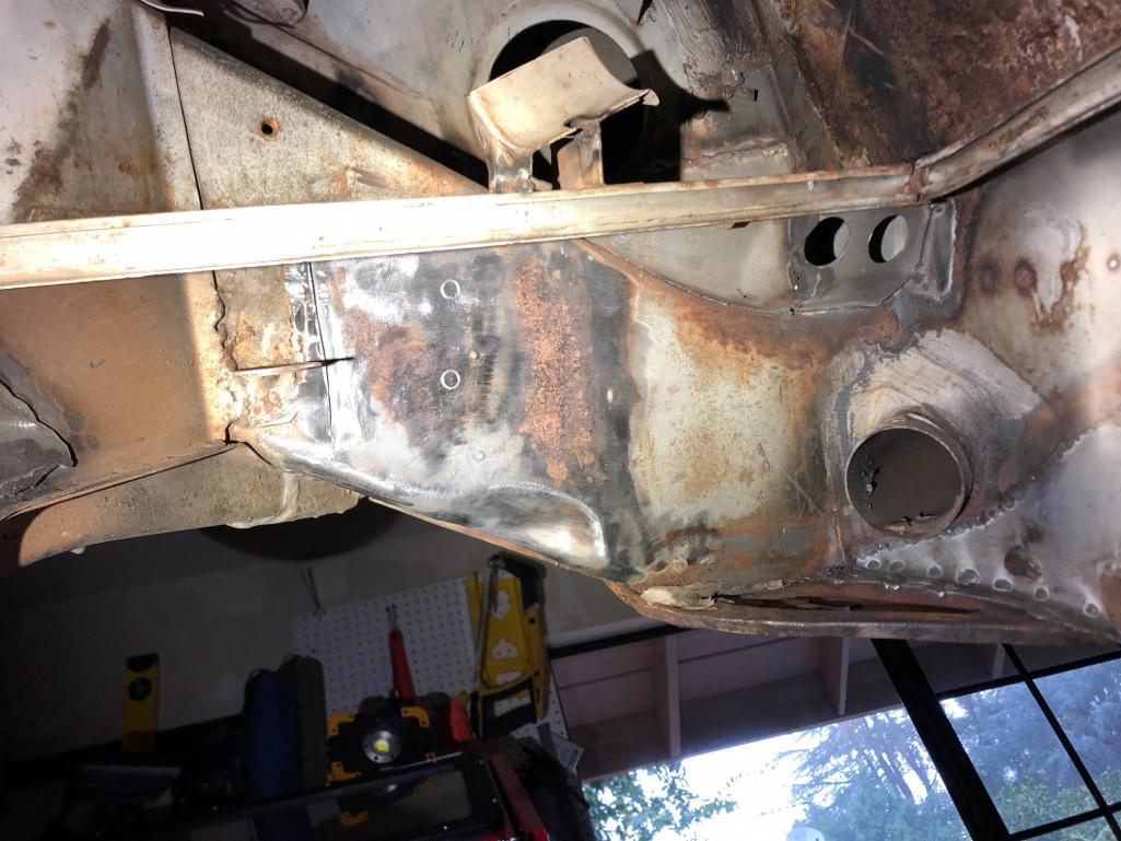

pencap914   Previous to the last owner, the rear floor pans, h...   Jun 19 2020, 12:05 PM

pencap914   Update: So I bought this car knowing the tub was ...   Mar 14 2021, 10:29 PM
mate914   Most all of the rear pillar strength comes from be...   Mar 15 2021, 07:27 AM
pencap914   Most all of the rear pillar strength comes from b...   Mar 15 2021, 10:15 AM
