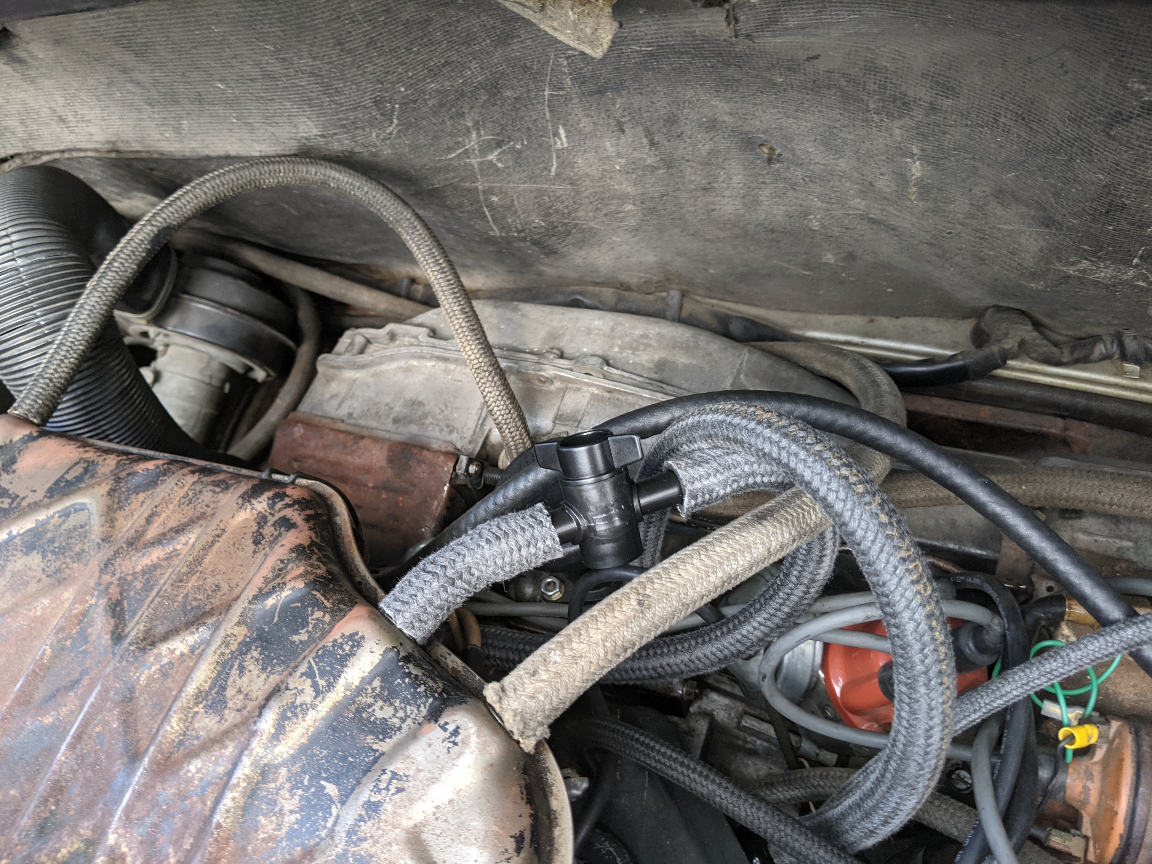

Ok fellas, here’s the run down Aux Air Regulator (AAR) and Cold Start Valve (CSV)/injector both work fine. Many of you have also been keeping up with my high idle issue that we figured out.
But yet, when the car is cold, i.e. room temp, I don’t get the high idle I should on start-up. Instead she cranks a bit and then lumbers to life. Idle lopes around 700-800rpm and then smooths out as it warms.
In all other aspects of operation, the engine seems to be pretty happy.
Thoughts? Experience? (IMG:style_emoticons/default/confused24.gif)
-Van
See post #419 on page 14 for a synopsis of the outcome.

here is what mike (mechanic) had to say after i showed him the cold start description.
its either starving for air to burn the fuel its getting. AAV.
or its lean and does not have enough fuel. CHT.
as a starting point.
don't you love it. (IMG:style_emoticons/default/poke.gif)
but apparently it can be either.
there is a lot of fuel being splashed in there and a lot of it is condensing on cold surfaces so the air bit is important. car needs basically 10 times the amount of fuel at cold start up than when its warmed and at operating temp. i didn't realise it was that quantum!
he reminded me, it had been laid up for 15 years.
so you run it for a few months/year and see what faults develop if any.
in my car it could be that the CHT has started out ok and has progressively begun to "decay". have to retest.
or its the AAV. not opening correctly. either not opening enough at the start and not closing smoothly and timely. have to retest. he did say that 2-3 minutes was actually about right usually unless its really cold. then the thermo strip/spring is going to take longer to heat up from the colder engine block and ambient air and go a bit slower.
the thermo and cooling flaps were discussed. they could be playing into the hiccups speculated for either of other two - ie exaggerating them when its a bit colder here.
but they weren't really impacting a year ago he agreed. (i can test that with the car doing a cold start on the hoist by simply pulling on those flaps manually and easing them off, the cable is still there - which i might do when i get around to doing the other tests).
re emorygt350 idea of taking off a hose. yes. do that but....its a closed system. start the car with all hoses on. crack off a decel or aav line between aav and plenum carefully. you want to mimic an AAV valve if thats what you are after simulating. its a small ish aperture thats opening in the valve. so just crack it off like at one edge and control it.
one thing to remember is the AAV is in circuit with the AFM, so the flap might be being slightly opened with the AAV full open. i don't know that for sure, might have to dig around in the manual to see what it says.
as to what a cold start up is for a 1.8 - his view is - probably not that dramatic.
system would be trying to hold something like a normal idle from start up and not a lot more. maybe around the 1000 +/- rpm mark subsiding to 900 +/-.
and it would take anywhere from 2 minutes to 5 minutes depending on ambient.
but in australia he thought 2-3 minutes.
